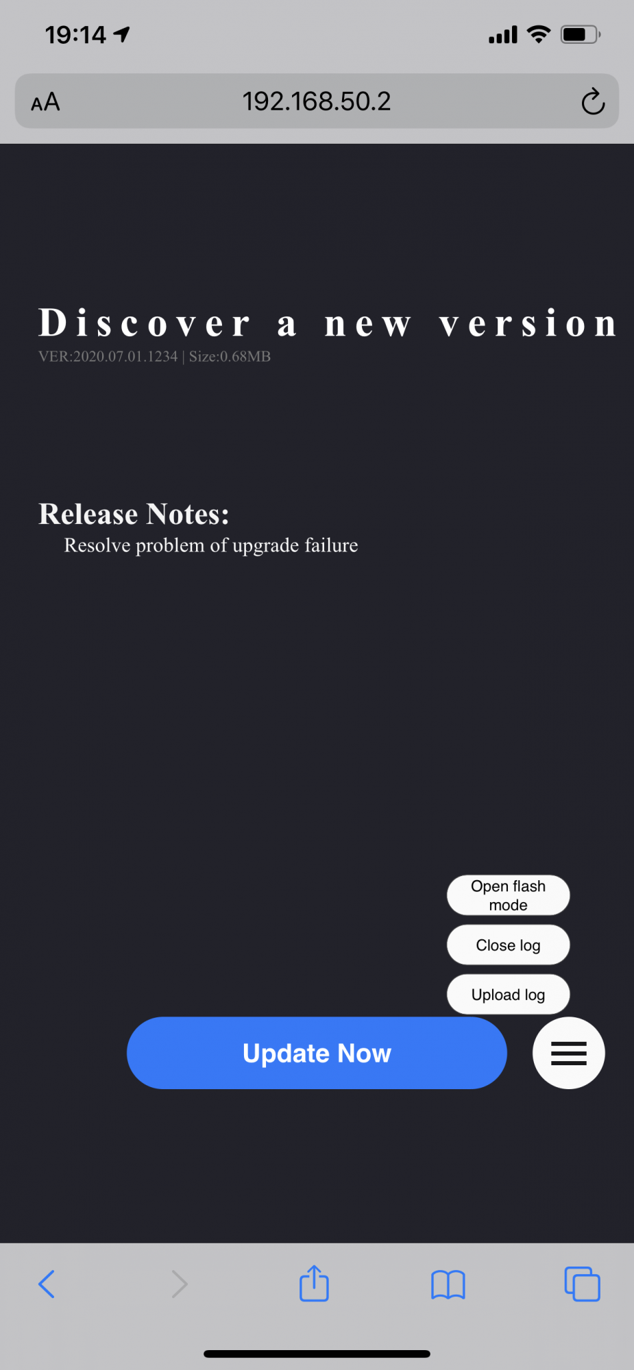

i can see this:View attachment 936030
where can I find current installed version number?
Yes, this is one of the shortcomings of their inelegant design. When there is an update available for your adapter, you will only see this screen, showing you what firmware is wants to update you TO, but not what firmware you are ON. Do any of the other experts on here know of a way to see what version you currently have installed? @2018 Denali? @LarryJoe33?
well it might not be problem but when i tried to perform an update, it was succesfully installed but nothing changed - it still offers same update.
Yup, that particular update was a "partial" update. It resolved the "unable to downgrade" issue. After you use that update, you can purportedly downgrade to previous firmwares, if that is what you wish to do. After that partial, @2018 Denali was able to roll all the way back to March firmwares, though he couldn't activate the adapter, so ultimately had to roll back up to a June/July firmware.
You can always tell the "partial" updates (or patches) based on their file size.
