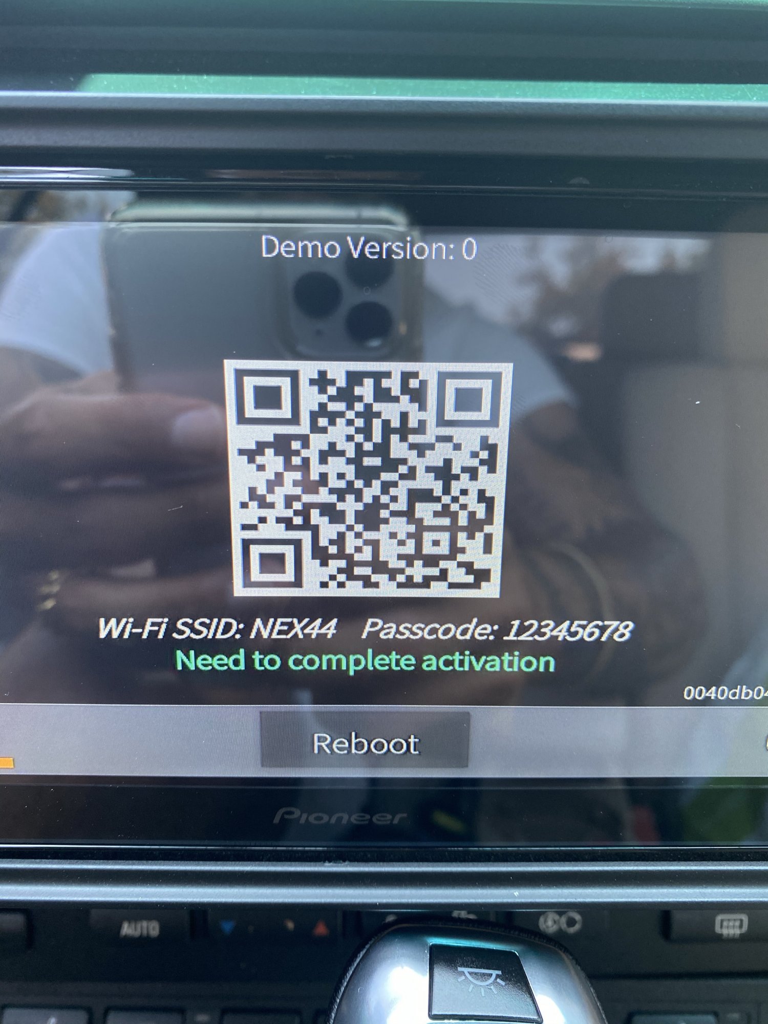

I have Carplay2air and I did the new update now mine says demo mode and won’t let me use it at all. I use it with my aftermarket pioneer nex2660 and iPhone 11 Pro Max. Anyone have any suggestions
Keep tryinng ! Mine did that - I “activated” it and didn’t restart for 10 mins or so and then restarted and it worked !

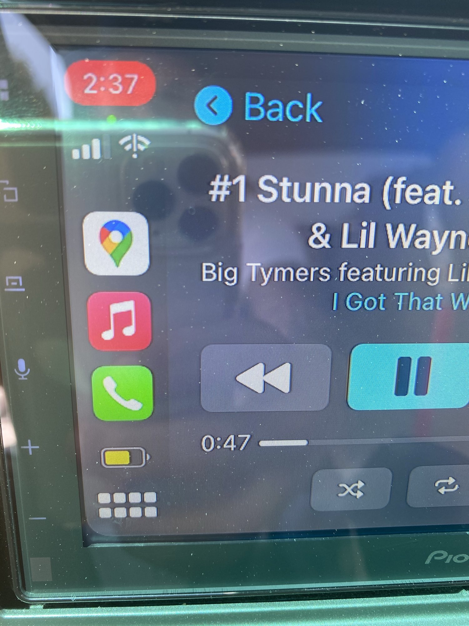

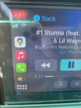

As I sent this it started to work but have a limited wifi symbol
That is a new feature of iOS 14 b3, just telling you that WiFi is not being used for your data connection. It has nothing to do with the Carplay2Air adaptor specifically, just wireless CarPlay in general.
