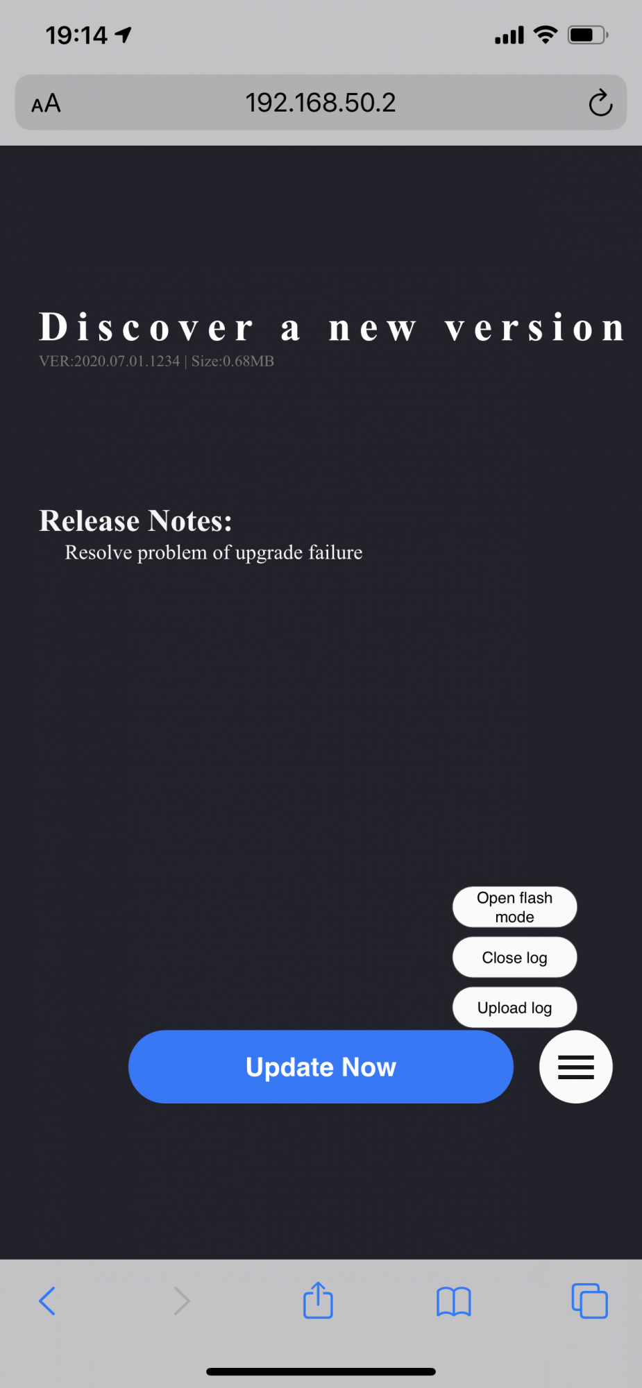

Little bit strange. A new OTA update from 2020.7.1. Resolve problem of upgrade failure"}

Plug the dongle into your car and once connected go to http://192.168.50.2/ and it will tell you what version you are currently running.
i can see this:
where can I find current installed version number?
