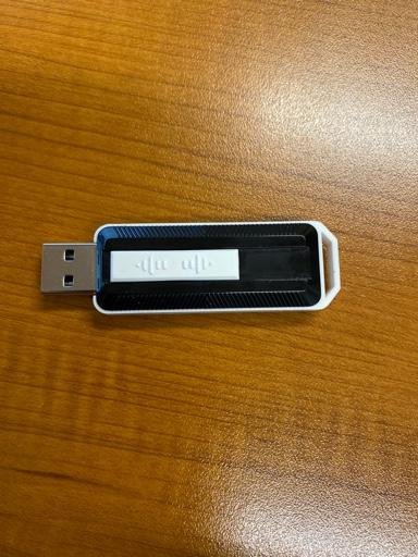

Just so I got this straight:
Format a USB Thumb Drive to FAT32 (the smaller the better)
Drop the image file to the root (nothing else on the drive or in the hidden trash)
Plug the drive into the dongle
Plug the dongle into a quality power source
Wait for the lights to do their thing
Sound right?
If you have an iPad charger, use that over quality power source.
Went with the 128MB. I think it worked correctly. Lashed green for about 30 seconds and then went to solid red. USB-C. Sound right? Still plugged in to be sure.
I had done exactly this to my bricked USB and it only shows the green led, never showed red. When I try plug into a car or an iPhone charger no lights.

Ok, success! For the files:
USB-C
Was running 1.22
Flashed directly to 7.29
Maserati Ghibli

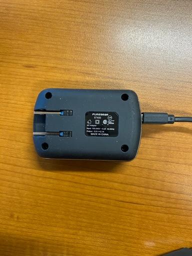

I used a 128MB no-name thumb drive formatted in FAT32. Image file put at the root. Plugged the thumb drive into the dongle, the dongle into a 5V/2.1A brick and then brick into outlet. Flashed green for about 30 seconds, then to solid red.
The one and only time I tried to manually flash was with a USB-A and I used a USB charging station for power and a 32GB drive. It bricked it. I have a feeling it was the power source.

I know someone a few pages ago said they thought they had an issue because the charger had too much juice (high powered charger). This is highly unlikely. If you know anything about electronics, you know that a 10A charger acts exactly like a 1A charger unless you go over 1A load in which case the 1A charger will drop voltage and cause issues but the 10A charger will not do this until over 10A. The ideal USB charger will provide 5V output until very high currents. The load then decides how much current it wants and problems can occur when it asks for more than what the charger can supply.
Power draws whats needed: True to an extent but I would not use USB multi charger that try to vary current for best charging. I have house full on Anker 5 and 6 way chargers. They work great for charging but because their "intelligent" I can see them causing issues. I would use simple charge brick. Even a 5 watt charger brick that came with most iphones is enough.

I agree... for anything that could brick a device, I would use a basic supply with no smart settings from a reputable supplier and one with as much juice as possible. You want something that just keeps that output at 5V under all circumstances... not something that might try to be "smart" and change it. My comment was more along the lines of "too much juice" not being an issue. It is possible that there may be other reasons a power supply with a lot of juice could cause issues.... like being smart.... but the too much juice component is not an issue.

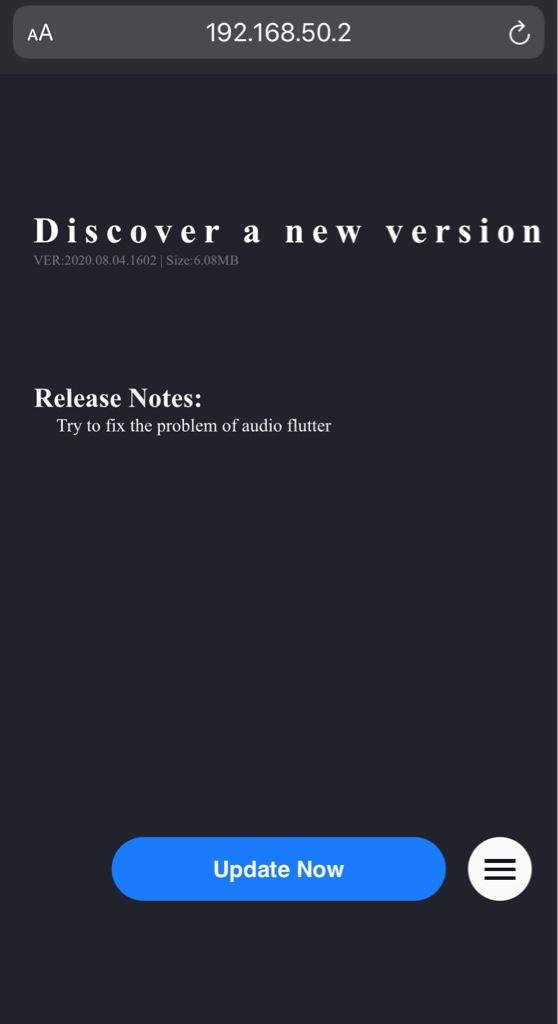

${"filePath":".\/download\/2020-07-07\/U2W_Update.img","fileSize":"717332","fileName":"U2W_Update.img","version":"2020.07.01.1234","updateTime":"2020-07-14 20:59:29","updateLog":"Resolve problem of upgrade failure"}
Another useless download..said fix flutter issue...2017 cla 250 still drops connection..If they don’t make vehicle specific firmware issues will not get fixed
08/04 is out OTA as well. Never could get the 2020/07/29 to boot up completely in my Chevy colorado truck had to downgrade back to 07/17. Hoping the audio static fix experienced by those with GM radio's persist in this 08/04 OTA. This updated and booted on my short drive this morning. remains to be seen what happens to the audio after 5-10 minutes.
UPDATE: No audio distortion after a 20 min drive. Only other firmware to successfully handle that in my truck was 03/06. Steering wheel controls and Siri work without significant delay. Happy camper and no more updates for me unless I read here the new version both works on GM radios and offers something I don't have with this firmware.
I updated my USB-C Carlinkit to the 7.27 version via USB figuring, if nothing else, it would probably bring back the red LED light. The firmware did make the light start working again, but the unit would not connect at all anymore to my car (no messages in the infotainment system at all). Interestingly enough, the unit was also broadcasting an "AutoBox-xxxx" SSID that I don't remember seeing before. I was able to connect to it by using the "12345678" password, and then checked for an OTA firmware version, and saw the new 8.04 version. I updated the unit and now my infotainment system recognizes the Carlinkit again. I don't expect my Mazda issues to be fixed, but will post if they are.
I am guessing 7.29 and 8.4 are the exact same fw. They got a lot fixed with 7.29 and decided to push it OTA as official.
You may very well be correct, but my earlier version carlinkit can successfully boot and connect with 08/04 after OTA upgrade from 07/17. I have been able to manually upgrade and downgrade all the June and July firmware, except 07/29. Tried 07/29 5-6 times since release and it never bricked my device, but the carlinkit would go through indefinite reboots when 07/29 was installed making it as far as the normal carplay screen every now and then, but ultimately crashing and rebooting every time. regardless happy with where I am now in regards to function.
