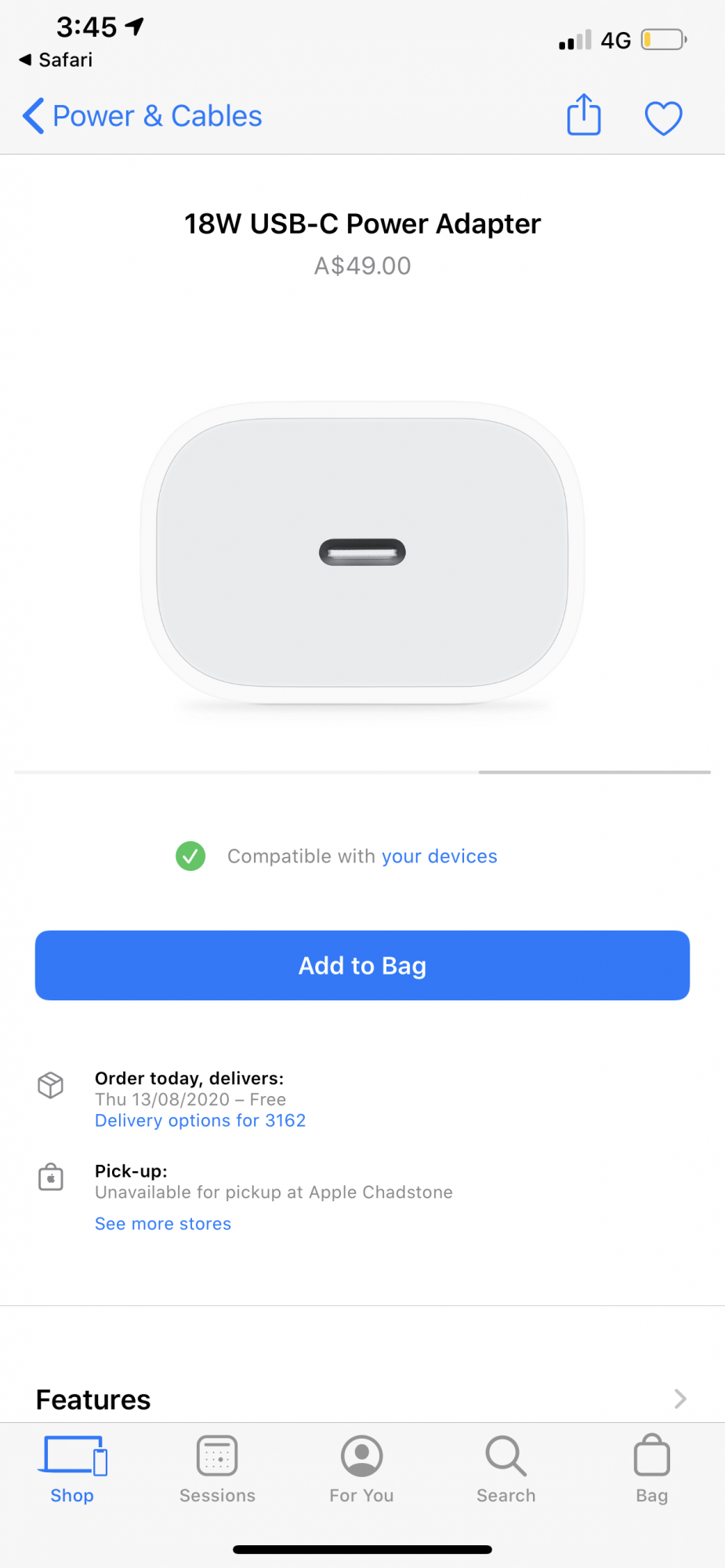

thanks for the detailed reply. I have an iPad Pro charger (USB-C) to USB-C so I was using that and then even tried USB-C to USB-A and then used the CarPlay Adapter USB cable to the power adapter. None have worked. Units are showing no lights whatsoever. Before updating to 04-08-2020 I was able to get a solid green light when connected to my MacBook Pro USB-C charger but now I don’t get anything. Even when connecting with official lightning USB cable to iPhone it doesn’t charge which makes me think the units are completely bricked. Which adapters are you all using?
this is the one I am referring to

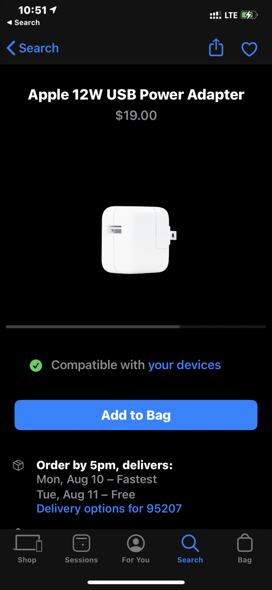

Use this adapter.
iPad USB-a adapter.

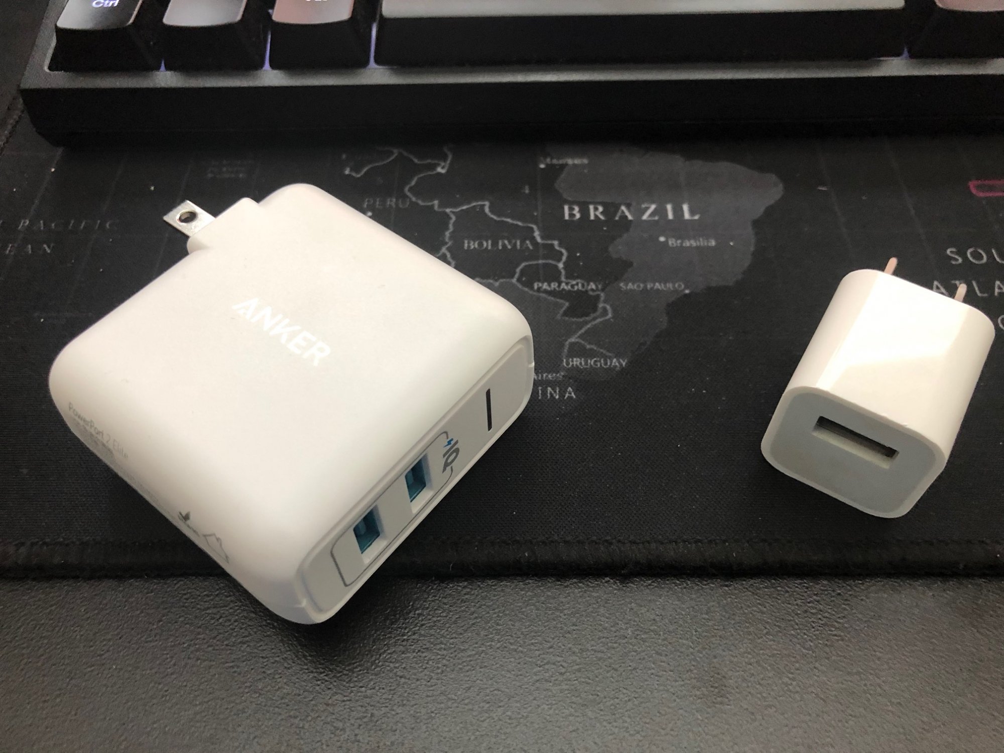

Yes, I have this one as well. And I have two other adapters that have also worked previously. See image below:
I will add, that the one on the left (Anker), is a "smart" power brick, and as others have mentioned before, this may not be a great idea to use for USB updates. I have, and it was no problem, but I guess I can see the issue with a managed charger not providing a consistent power stream. Just an FYI.

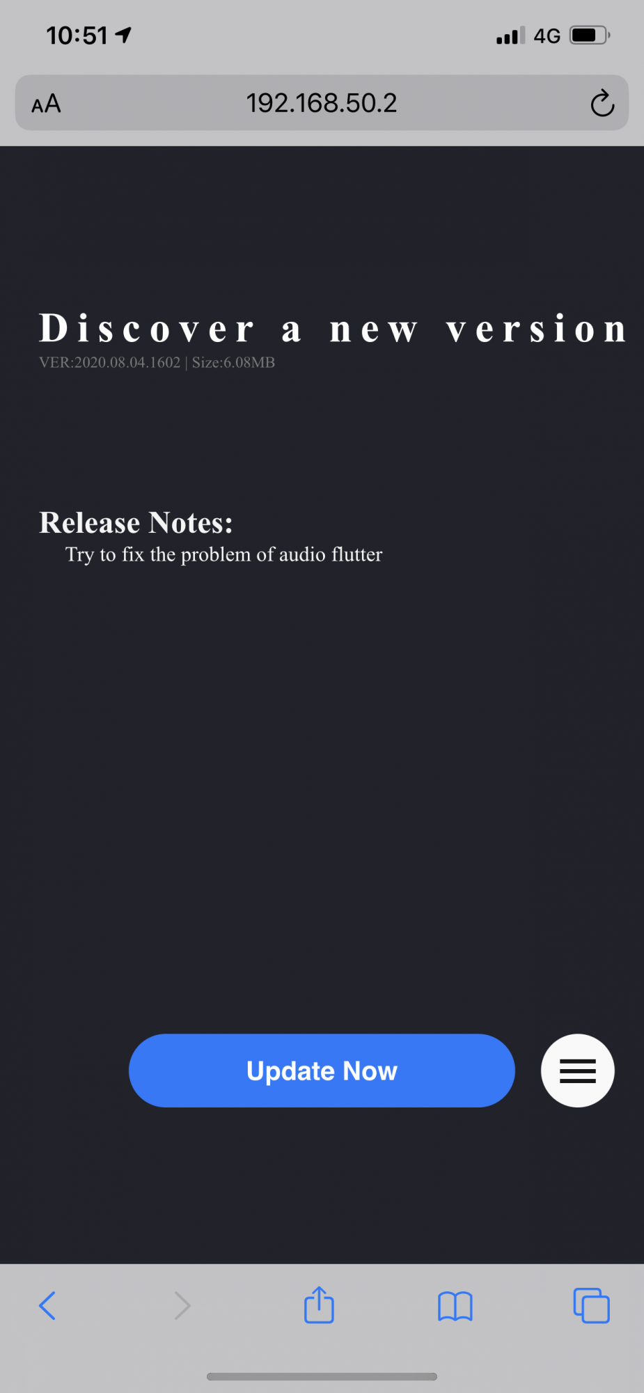

ok thanks so just to confirm.
In vehicle plug in working unit that does not have current firmware on it so you see the screen (attached)
Then connect iPad 12W power adapter to the USB-c to USB-a cable that came included with the CarPlay adapter.
Then use an official iPhone cable from CarPlay adapter into the iPhone. Press Update Firmware.
wait for it to complete, (unsure if I should see any lights at this stage?)
go back to car, test our bricked unit and report back here?

I plugged my bricked unit into the power supply AND powered it up, before I plugged in the Apple lightning cable and then plugged my phone into that. Waited about 30 seconds, and then clicked "Update".
It'll spin up through the progress bar - up to 100%, then it will circle while it says "Upgrade in progress, please wait, may take a while to complete". Then, it will state, "Update Complete". At which point, I *think* the dongle will reboot, all by itself. So wait a couple minutes after the "all done", and then go try it in the car.
Good luck. (And, yes, I know this all sounds nutty...but it worked for me.)
Well, again, I'll be a blue-nosed gopher. This actually worked! I have a resurrected CPlay2Air unit now!
I did exactly as Denali outlined. After plugging into the lightning cable, I clicked "Update", it slowly worked its way from 0% to 100%, then gave me a spinning ring with the message "Upgrading, please be patient, this could take a while". It then reported, "Upgrade Complete". So I unplugged everything, took it back out to the truck and BAM, it came back to life! Head-unit saw it, and I was able to join it with my phone. All good!
Now here is the weird thing: After joining the adapter's WiFi manually in the truck, I navigated to 192.168.50.2 and it reported the firmware as 7.17 (which is what was on the adapter when I bricked it)! So I disconnected, and reconnected via Bluetooth (which then handed off to WiFi) and re-navigated to 192.168.50.2 and it is now offering to "Discover a new version..." to 2020.08.04.xxxx. I was too scaredy-cat to try another OTA update, so I shut down and have brought everything in the house to do a manual USB update to 2020.08.04 and see if that works.
So, to sum up, I am not totally sure exactly HOW this works, but it certainly does. I had a totally unresponsive, completely dead / bricked, CPlay2Air adapter, that would show absolutely ZERO lights, in the truck or when plugged into a power adapter, that now is working again. And while I'll be the first to admit that I was very skeptical about this technique, given my years of experience with networking and routing, I am extremely happy to report that it works! Or at least it did for my bricked unit. YMMV.
