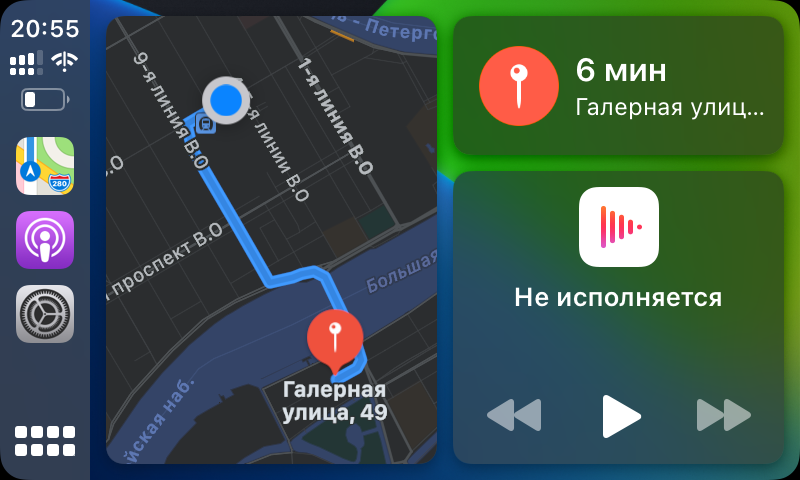

hey all!
I’ve updated to iOS 14 and now I see this WiFi! logo instead of LTE. Have anyone else encountered this behavior? Any ideas on how to fix this?
Thanks in advance!
