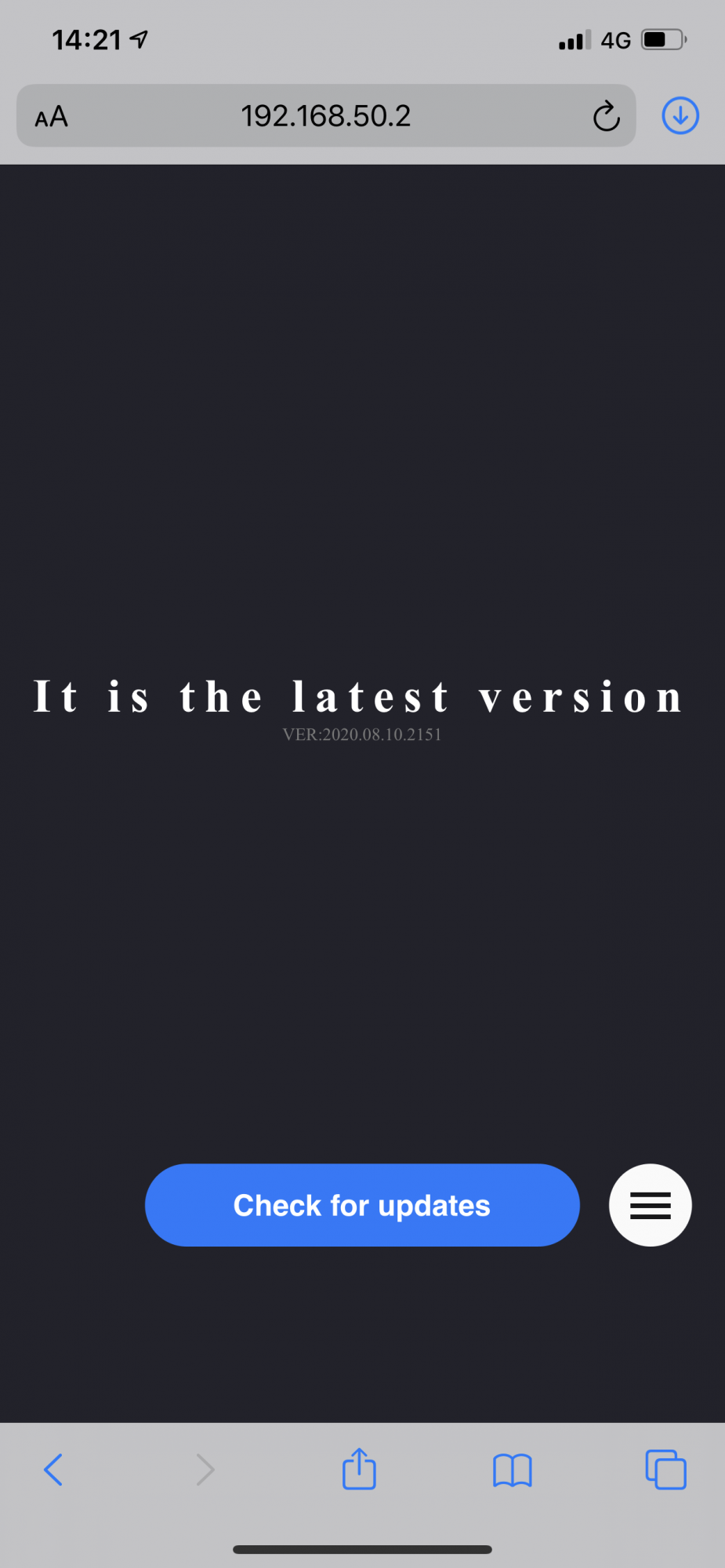

Done the latest update on my USB C carlinkit device used OTA this time - I’m running fords Sync 3.4 in a Focus in U.K.
So far working fine no noticeable differences in the usage but only tested a few minutes - some new settings in the web UI - not played with any yet.
Reactions: vesalius

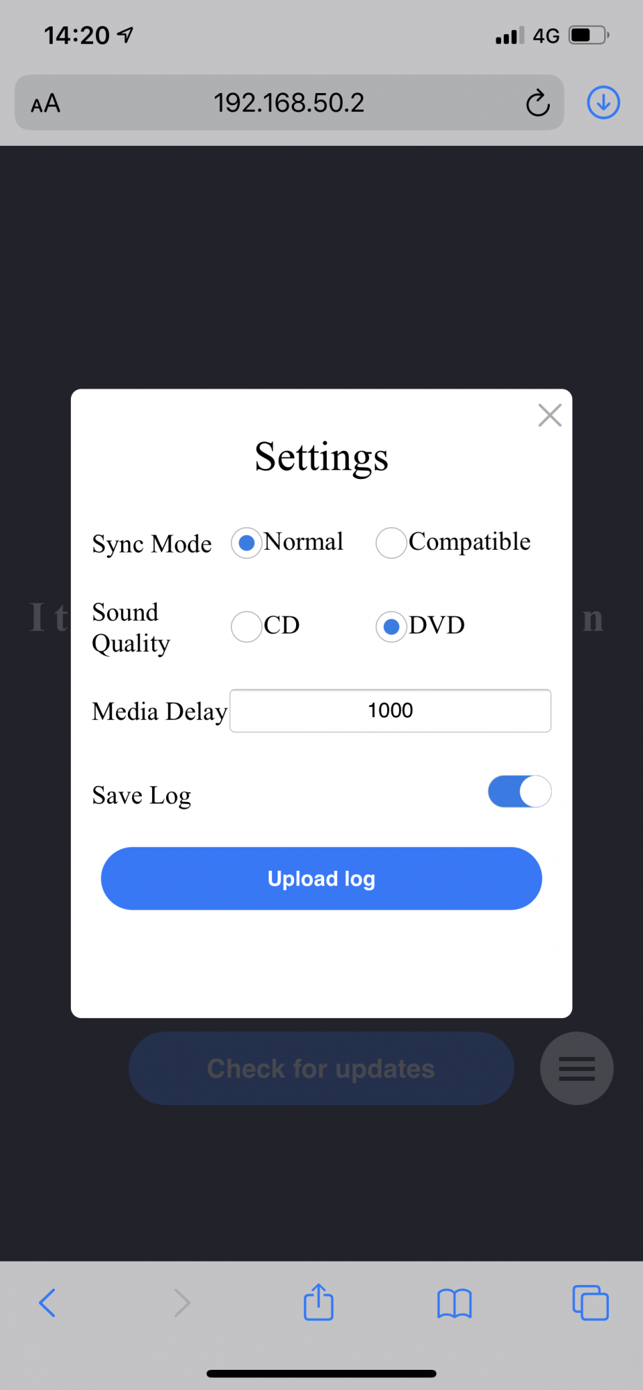

Thanks for the pics and update. Waiting to hear from my GM/Chevy radio brethren that try 08/10 for more than 10 min to see if the distortion bug has not reappeared.
Screenshots are interesting! Thanks for posting them.
The CD vs DVD sound quality is a bit bizarre, but my guess is that they mean lossless vs lossy compression--CD being technically "better" than DVD because the audio on DVDs uses lossy compression.
In the real world almost no one would be able to tell the difference though--lossy compression has come a long way since Napster days.

Didn’t think of it like that - it is a weird way of stating the 2, dvd was set by default next time I’m out I’ll try change to CD and see if notice any differences.
The audio delay is set to 1000 by default - you can change between 300 and 2000 or 3000 I think it was - I didn’t notice a difference when changing it to 300 but didn’t play with it too much.
Agreed lends itself to multiple interpretations. I imagine Most will consider DVD higher quality than CD based off the video side.

I wish there was a bit more info on the new settings - even the audio quality one isn’t fully clear which one is the better option, hopefully we will hear abit more information on the options soon.

Ahh, i cannot find differences between CD and DVD quality. 🙄

Ok I updated to 8.10. The delay definitely does something. When set to 300 I got audio skipping. Through process of elimination, I settled in at 500 and CD quality. I’m not sure the CD or DVD setting does anything. It seems the delay setting results in faster track change. You have to reboot the device for the settings to apply.

Do you remember your default settings? I’m curious if the unit is smart enough to alter these based on the unit it detects or if they go for a one option fits all option (which I suspect is the case here)
Edit: Played with my settings a bit too, like you on 300 I got audio stuttering, same with 400 so I settled at 500. I tried CD quality and for some reason my car at first treated it as a phone call rather than audio playing so only come out front speakers - it did correct it’s self but that was odd, I did set back to DVD. Track skipping is pretty good now, I’m not on iOS 14 yet so hopefully see the improvements mentioned with that and it will be pretty instant!
