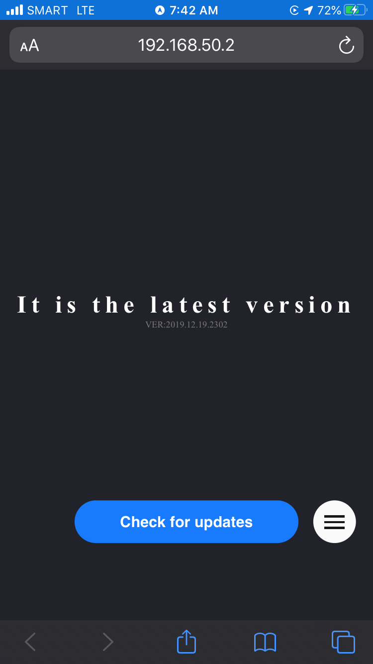

The fw did not work as my Carlinkit U2W with the USB A plug is bricked which has only the blue led lit up when plugged in.
Anyways, here's a short backgrounder on how I managed to brick my device - not that anybody is interested to know.
So my USB Type A Carlinkit which I bought thru eBay last Jannuary was working fine without any issues that were being reported here in this thread, no 5min or so audio glitching, no black screen, no out of the blue disconnection. It just worked out of the box. And because of this, I never had the urge to update the darn thing.
Anyways, fast forward to July 24, 2020, I was browsing around Lazada (its an online shop here in SE Asia similar to Amazon and eBay), and lo and behold, there are lots of ads for Carlinkit U2W Type C version and were priced at around US$90.35 with free shipping. So I thought this is a good opportunity to "upgrade" to the USB C version which is having good reviews from here in this forum particularly the "faster" bootUp and connection, etc etc...
So... I paid US$80 for the dongle [used a discount code]. Ordered July 24th and received the package July 31.That was fast considering the COVID19 situation down here and the dongle coming in from CN.
Tested the new USB C dongle on my GM vehicle, seemed better as was described by the experience of other members here. Checked if there was an update, and there indeed was an available update [7-17] but I din't update as the dongle is working flawlessly.
Two weeks ago, I decided to update the USB A version, checked for an update, it said something like 6-17 was available, clicked update, got stuck at 90% for a couple of seconds until it finally rebooted. After carplay came back on, I checked for an update again and it said 8-10 was available, clicked update, Update Success message, it rebooted, and then nothing!!!!
And that folks, is how I managed to brick my USB A dongle.
This forum has the most comprehensive discussion regarding these carplay dongles, and right now, I'm just waiting for a post that would, or could, somehow resurrect a bricked dongle. LoL
BTW, that USB A dongle had fw 2019.12.19 on it before It got messed up.
Cheers!
