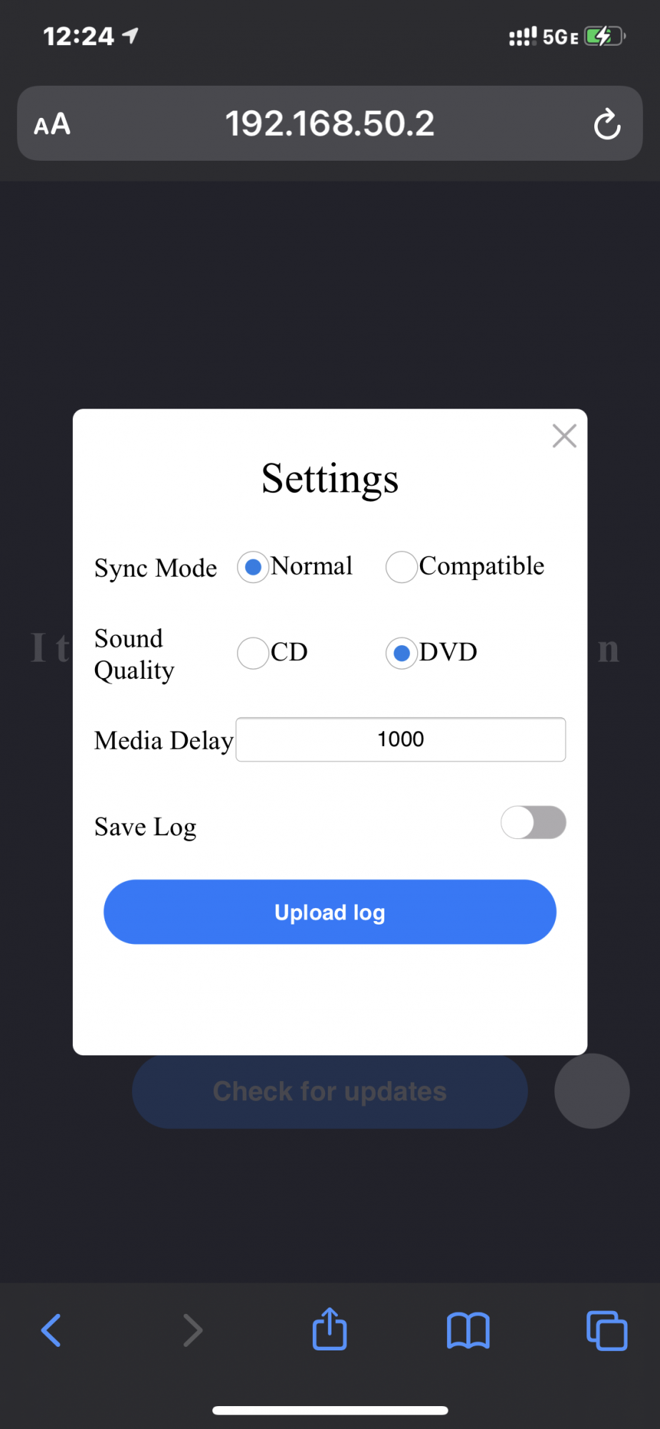

Carlinkit helped my to activate the dongle, I uploaded a log to them and sent a screenshot to them and now it works!

But I found something interesting over the weekend: Carlinkit plugged in, no bluetooth (in troubleshooting the Carlinkit I removed the CUE system from bluetooth pairing altogether), I was driving and realized I have no music because Carlinkit refuses to connect at vehicle start and I hadn't plugged my phone in. Plugged my phone into it's regular USB port for CarPlay and when I did that it came up on the wireless dongle instead of the cabled connection.
Still scratching my head on that one.

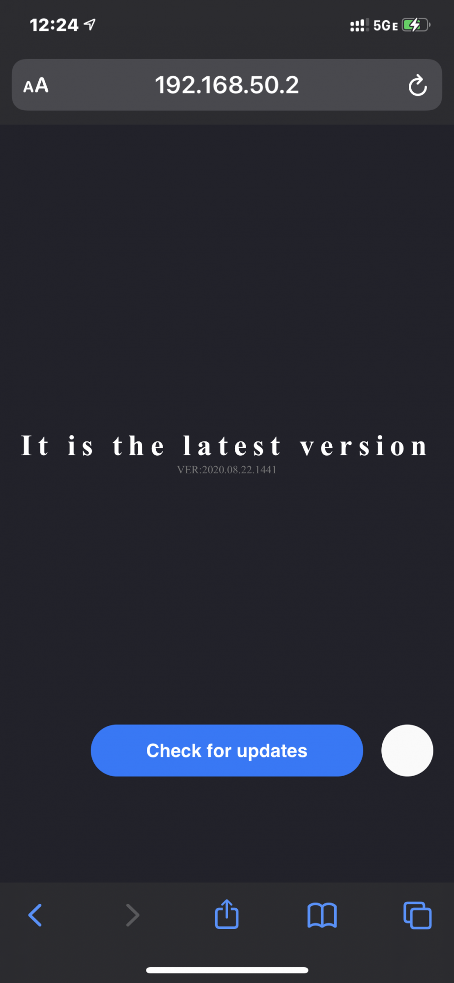

Good news GM owners!!! Looks like Carlinkit has finally fixed the need for a start up time delay relay in the manual firmware update 8-22-20.
I’ve been running it for a couple hours and plugged into a regular USB port and has connected every time now.
Looking at the lights from my CarPlay2air it blinks red at start up then I think it checks if it’s displaying anything on the screen if it’s not it restarts itself and then connects total time about 25-30 seconds.
Good job Carlinkit!!!
I knew software could fix the issue!

It’s a manual usb install only at this time. I’ve been using it for a couple hours and no 5 minutes noise issue.
Yes firmware is for both Carlinkit/CarPlay2air dongles.
