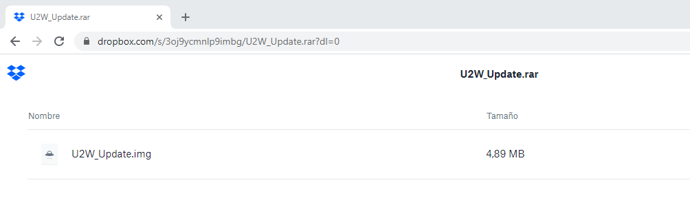

Carlinkit sent the following via WhatsApp last night:
"Hello there,
This is the latest version of firmware upgrade, you can try.
Please enter the link to download the unzipped folder and unzip the file "U2W_Update.img"
Upgrade video: https://drive.google.com/file/d/1akjOcSqQE3Uf8dfrO8n0JFlvPhzsC_Tc/view?usp=sharing
This upgrade method is different from the past, you need to pay attention to 100% follow our upgrade steps, otherwise the dongle will die.
Please refer to the attached picture.
About upgrading the dongle/power adapter to upgrade the dongle:
●Preparation materials: product dongle, power adapter, USB flash drive
●Method:
1. Please save the Auto_Box_Update.img file on a USB flash drive
(The format must be FAT32 / allocation unit size 1024bit or the default value) root directory, and insert it into the product's USB port.
2. Plug the product into a USB charger (please do not use the USB ports of cars and computers!!!)
3. Wait 2-3 minutes until the red and blue LEDs light up at the same time. Unplug the USB flash drive.
4. When upgrading the product, please do not turn off the power or unplug the dongle.
●For details, please refer to the attached picture.
After a successful upgrade, you can return to the car for testing.
Looking forward to your reply,
Best wishes."

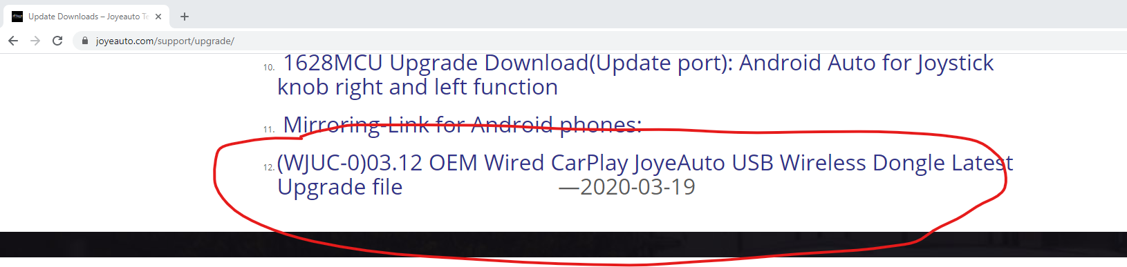

I'm not surprised you aren't able to flash to another version given prior posts from others who are also stuck on that version. I wonder if it was a build meant for the joyeauto device, and Carlinkit is preventing joyeauto adapters from flashing vanilla Carlinkit firmware? Just a guess.
