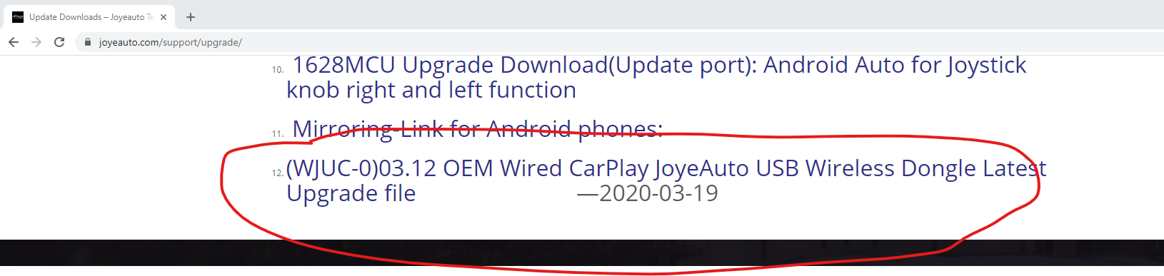

Investigating more about the new Joyeauto device (https://www.joyeauto.com/product/wj...factory-wired-carplay-to-wireless-connection/).
It seems that it also uses the "U2W_Update.img" file for the update. Also use via OTA http://192.168.50.2.
It clearly looks like a new clone.

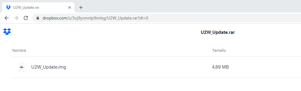

OMG !! The file that Joyeauto sent me (USB Dongle Update.img) is the same as 08.27 (U2W_Update.img) with the new interface.
I will then try to rename the file "U2W_Update.img" (08.31) to "USB Dongle Update.img" and test if it updates it.

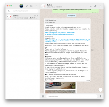

Here is the update I received from Carlinkit yesterday via WhatsApp where they say, "This upgrade method is different from the past, you need to pay attention to 100% follow our upgrade steps, otherwise the dongle will die.":

I also wonder if there is some thing in this build of firmware where it is looking for a different firmware name than the U2W_Update.img. The quote from their directions state, "1. Please save the Auto_Box_Update.img file on a USB flash drive..."
Uh, Auto_Box_Update.img?
I tried renaming the U2W_Update.img to that but it didn't work. Still looking for a firmware update solution that will allow me to at least get back to the 8-22 firmware that mostly worked.
