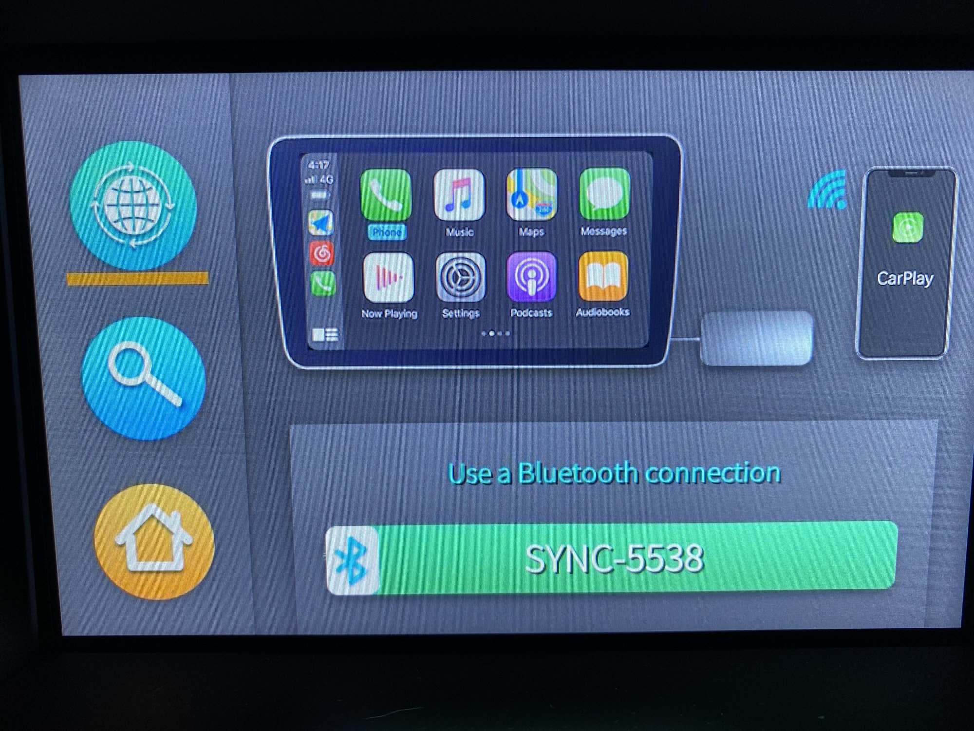

Have any pictures with the new startscreen?i dont like the nintendo one.

Haha, well I got it on my USB-C Carlinkit. Haven't tried flashing my USB-A version yet.
For the record, the "Connecting to iPhone" screen looks almost identical to before. It's the initial screen before that that looks very different.
Not sure why some folks aren't seeing it.
Edit: I should add that as soon as I plugged the adapter in and started the car I was prompted to set up a new CarPlay connection. I think someone earlier in the thread said they had the same experience. Did those of you seeing the old interface have to do that?
Maybe it's car-specific. For the record my car uses Ford Sync 3.
Yes, look above.

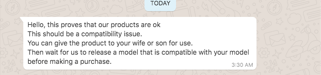

A bit discouraged by this response from Carlinkit support I got late last night. Especially since the official website does indeed list my year/make/model.
Yeah it's annoying, and that is why I asked about the firmware. It could require a certain version or higher to work on the ATS. Hopefully you aren't in a situation where the vehicle is MY 2016, but has a MY 2015 HMI system in it.
