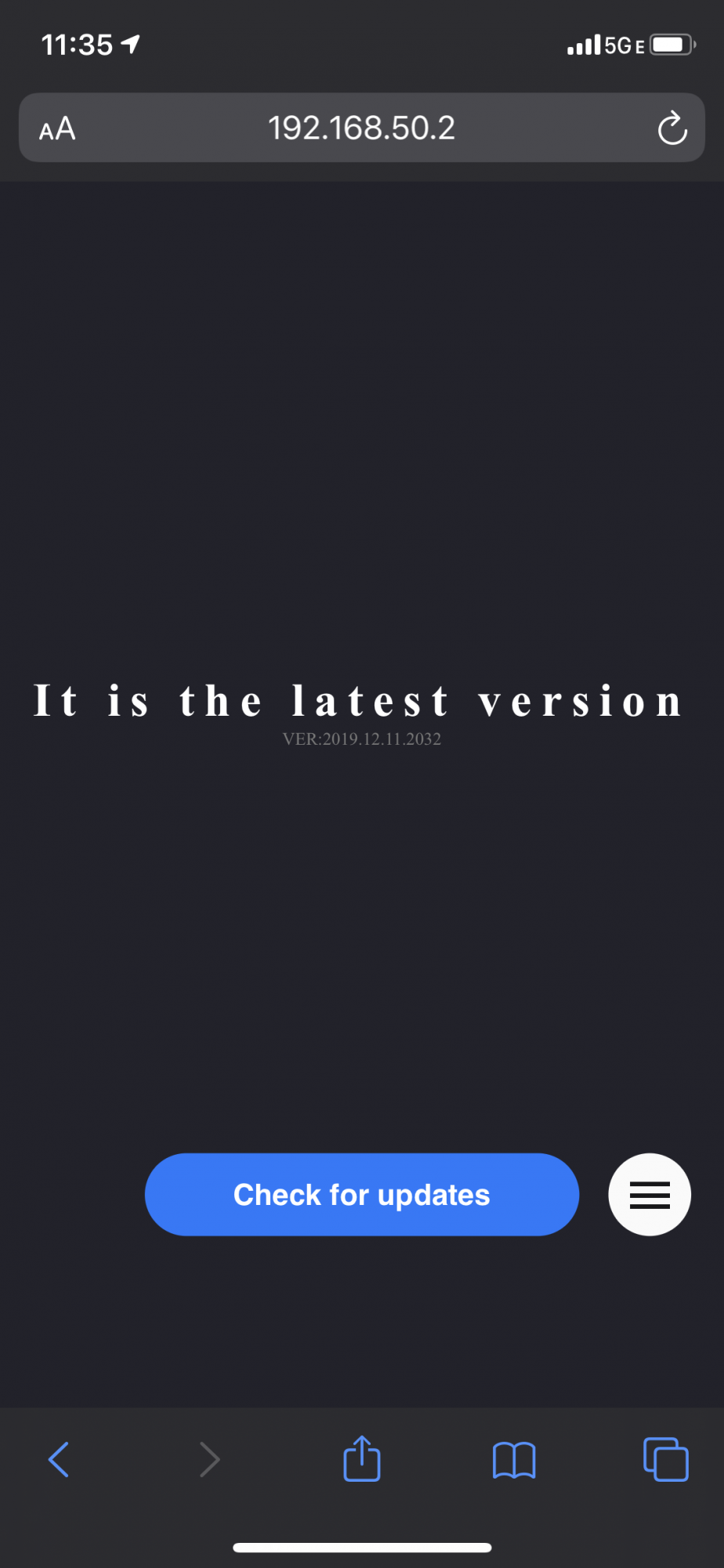

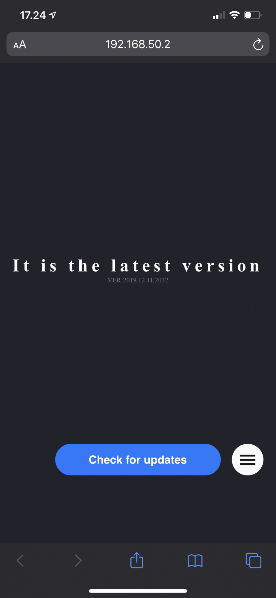

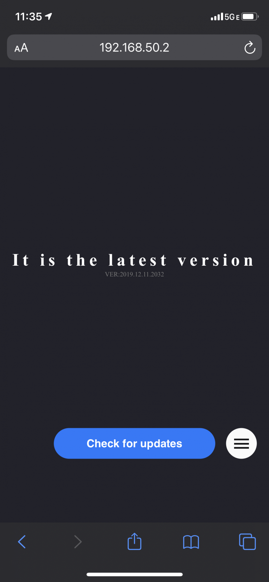

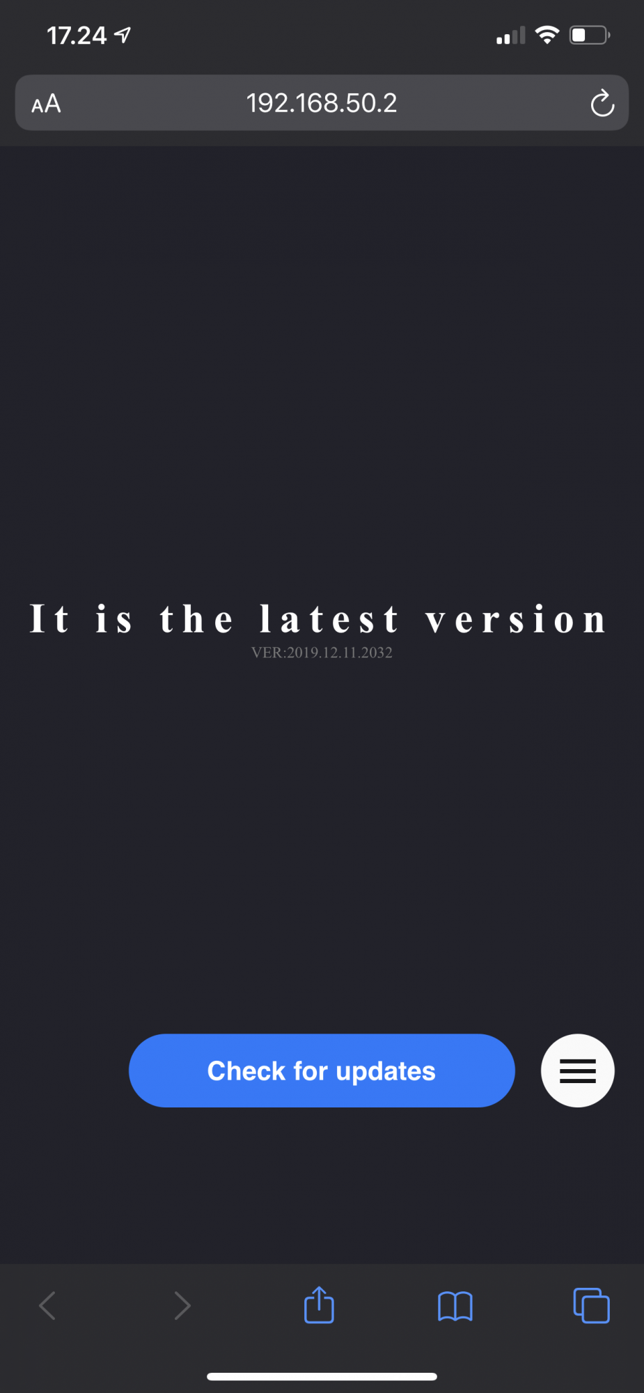

Now there's a 2019.12.11.2032 release, which claims to address connection issues, and wifi connection issues.
Upgraded to it without a hitch.
At the moment its check twice a day. I think switching from the img update to the over the air model has been a challenge for them
I updated mine for 30 min ago to 2019.12.11.2032.
Bug fix was improving connection speed. The speed is very fast now.

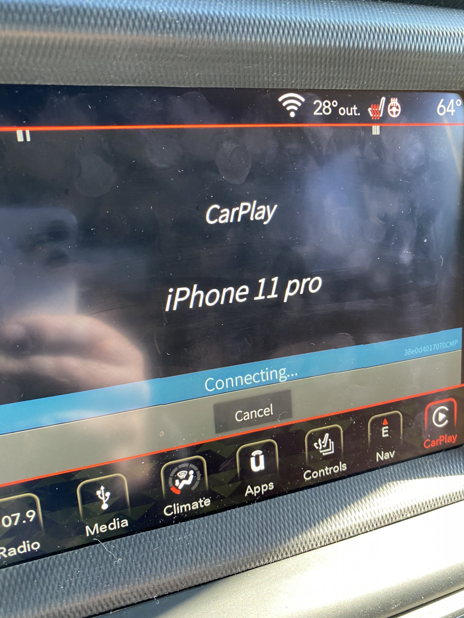

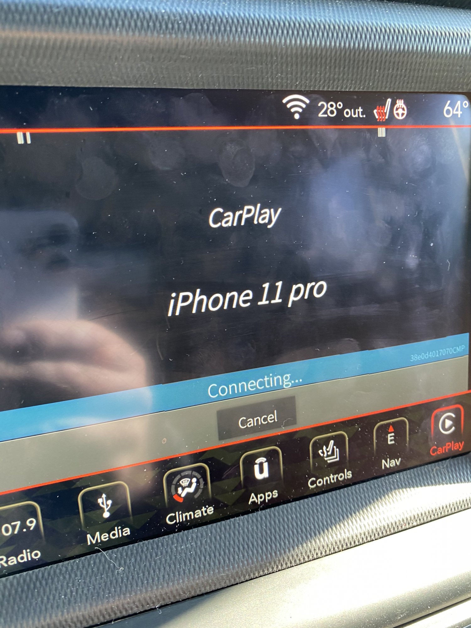

Well. After update. Still fail on the Jeep. Connects to CarPlay. But interface still doesn’t show CarPlay but instead pixelated connecting screen.

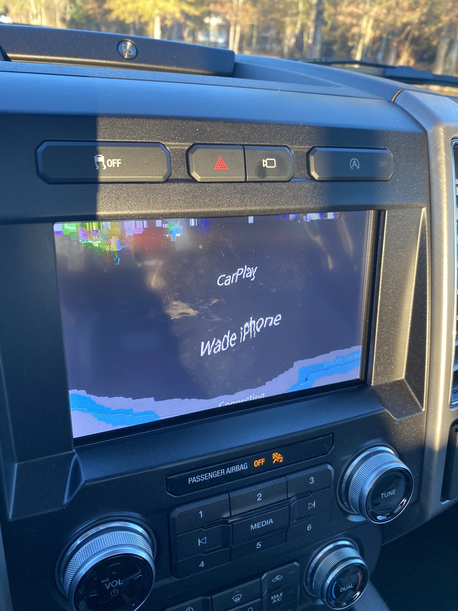

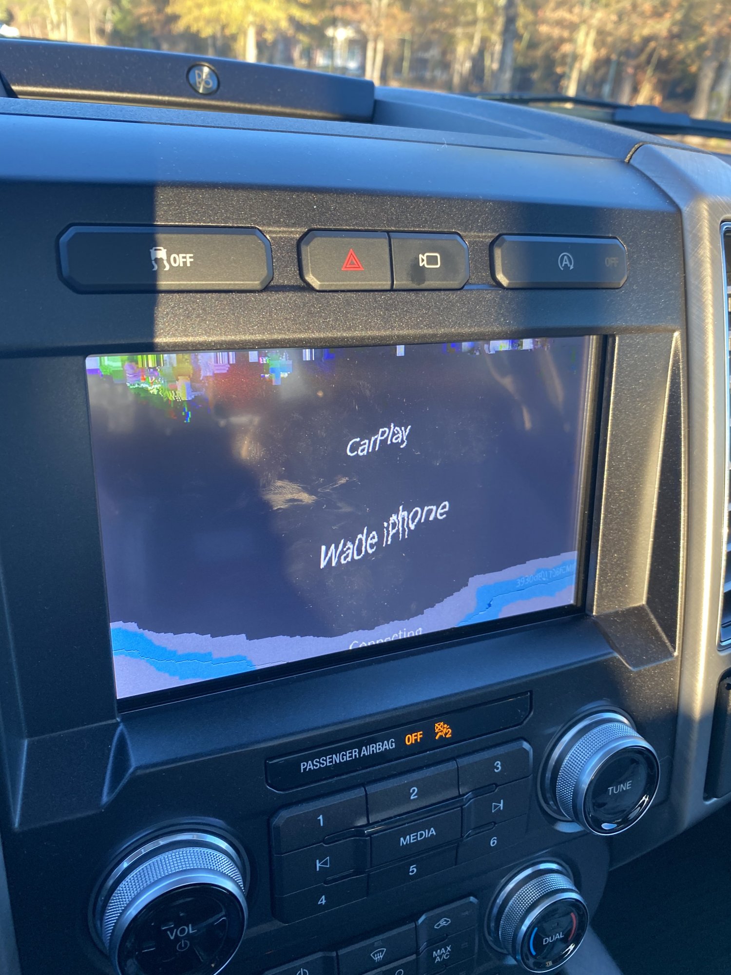

The Apple CarPlay screen is an h264 stream from the phone so it’s just a case of figuring that out on the head unit which at 2 firmwares per day sounds like they are really trying. I’m so confident I’ve ordered another one for the Ibiza that isn’t working yet.

Well again what’s mind boggling is the OLD 11.11 firmware worked perfectly for my Jeep. It’s until this abortion update that screwed me
