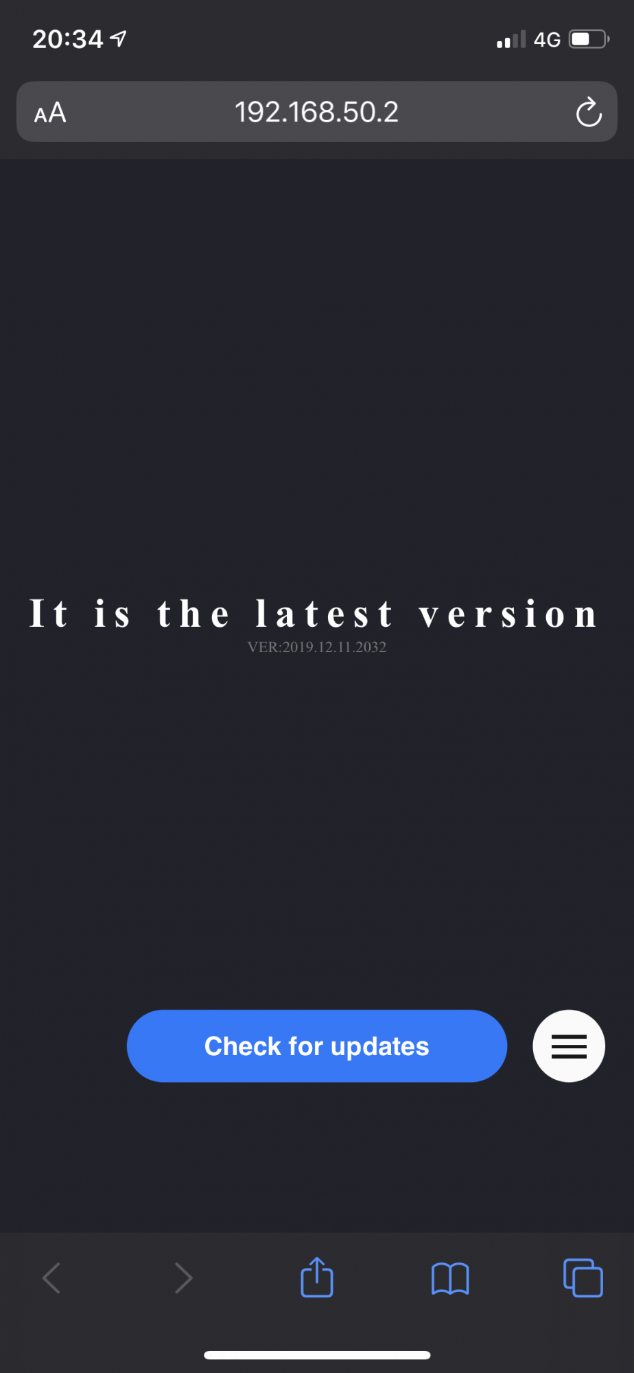

Well I just updated again. I know have 2019.12.11.2032. Update ran and said it was successful However it would not connect to bluetooth. I deleted it from my iPhone and it would not show up. Waited 10 minutes and tried again and it then paired again. It is working.
But real question is will it re connect on it own later today. I have had to unplug it from usb and then reconnect to usb to get it working each time. I hope this fixes it or it will be going back to china.
