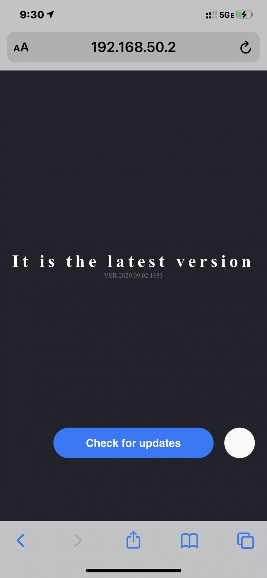

My CarPlay2air is my test unit now. It’s currently on 9-2-20 firmware. Has been connecting about 95% of the time without the delay relay. It’s been working good no audio glitching.
Reactions: Trader05
I just manually updated the CarPlay2air’s firmware to 9-3-20 will run it through tests tomorrow.
I’m not sure why some are having issues manually installing these firmwares.
