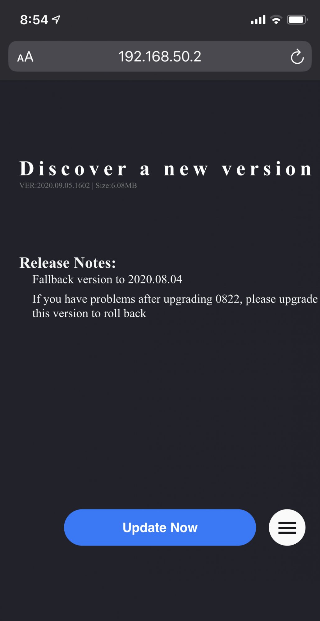

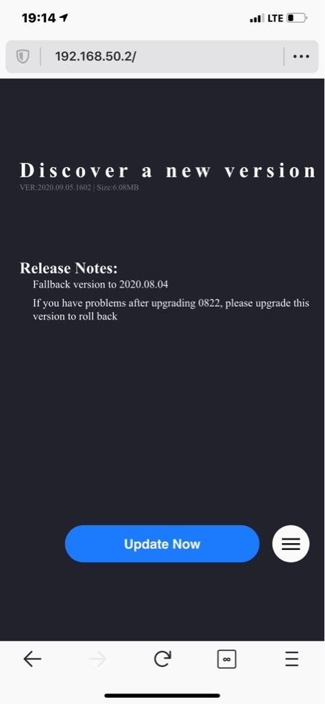

there is a new updates OTA 09.05.1602 today. Size 6.08MB.
Release notes: state that it is a fall back version to 08.04 version. for those having problems after upgrading to 8.22 to roll back.
So it’s not for everybody respectively for those that have no problems with 2020.08.22?! Or maybe with new startscreen?
