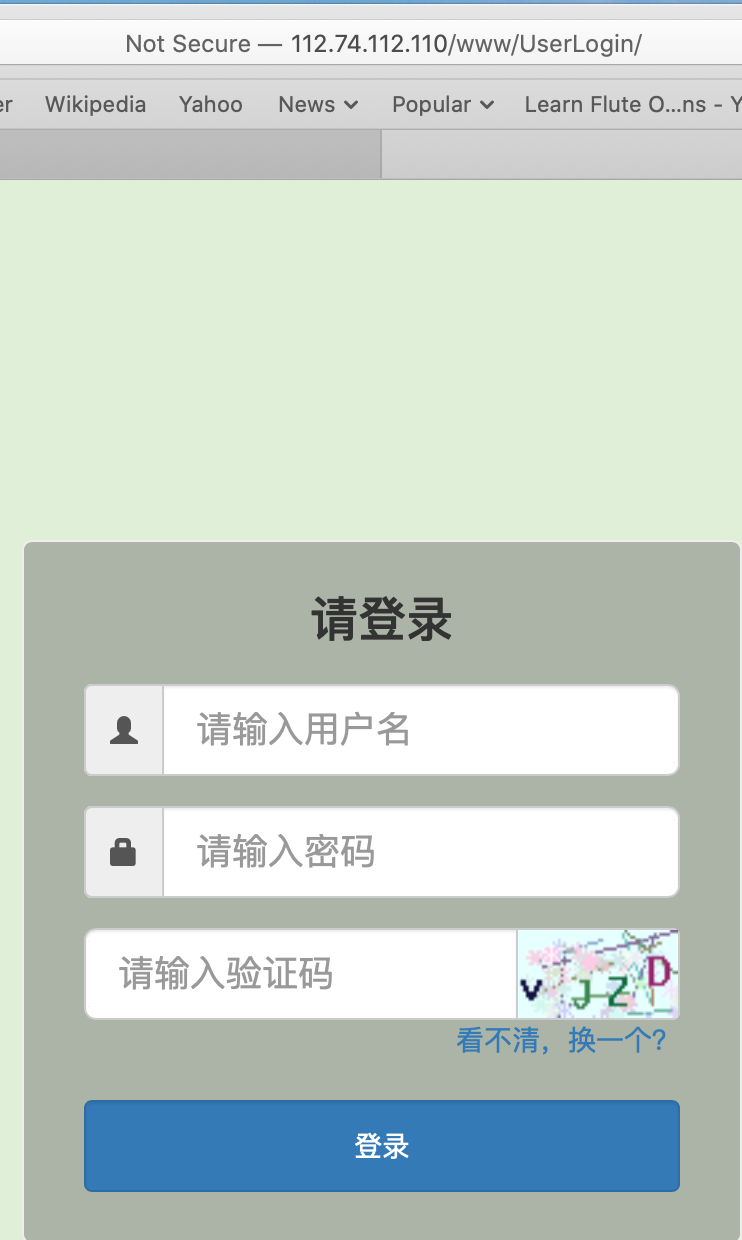

Well new USB-C offered a 9-5 OTA update which went through and said successful but when it started back up it was on 8-4 OTA and said its the latest. Looks like there sticking with 8/4 for now presume it was 1602 version roll back posted on 9/4?
