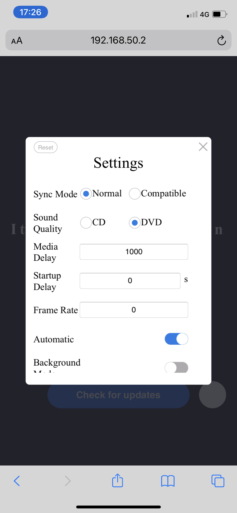

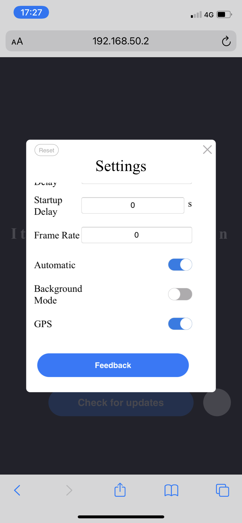

The settings options have become more extensive. Unfortunately, there is no more detailed information about it. I will test it more closely on my Alpine head unit.
