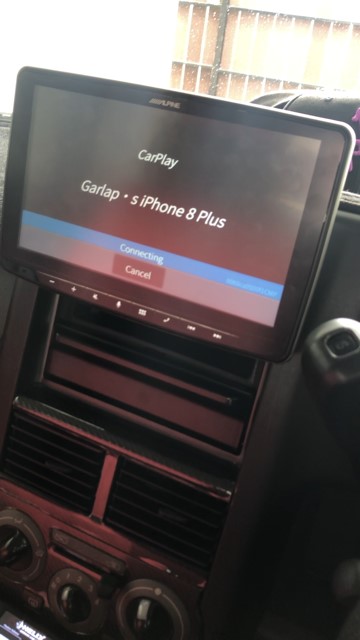

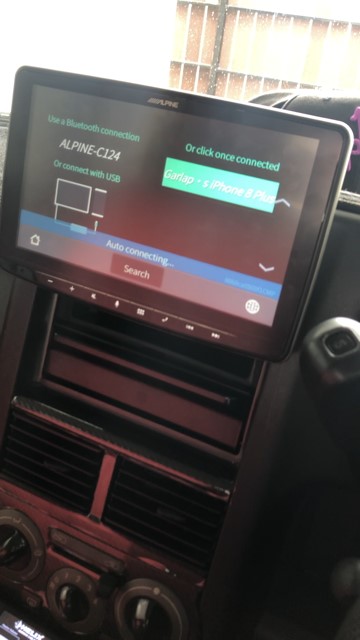

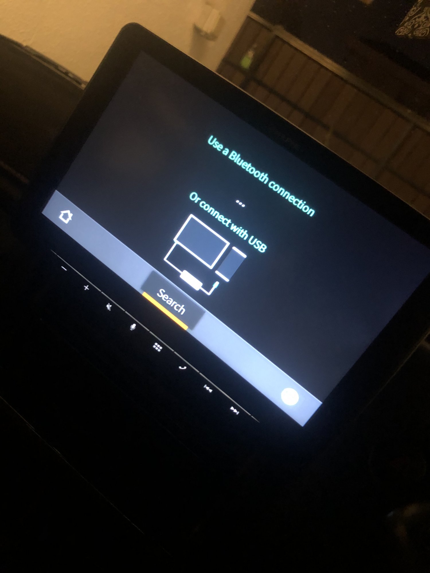

Good to know it works on some Alpine, my iLX-F259 is a lowest grade within the halo 9 range which has less features, simpler User Interface, etc... I hope this is not the reason why it doesn't work on mine.
I have tried the 2020.11.10.2137 (upgrade via OTA) and it just keep rebooting my Alpine Head-unit and cannot gets into the setup interface page. Not sure why
Yes, I've been using the dongle for a year first with Alpine iLX-702D and now with iLX-F903D and has always worked more or less fine. "Autobox-528F" wifi should not show up. Try deleting autobox-wifi on iPhone and reconnecting. For me the firmware 2020.11.10 is the best for Alpine.
@WPoly what Bluetooth's name show up on your Bluetooth connection screen on the Alpine? Do you have to delete the Alpine wired Carplay setting on the iphone?
Many Thanks!
Many Thanks!

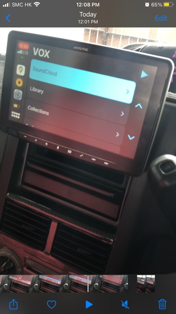

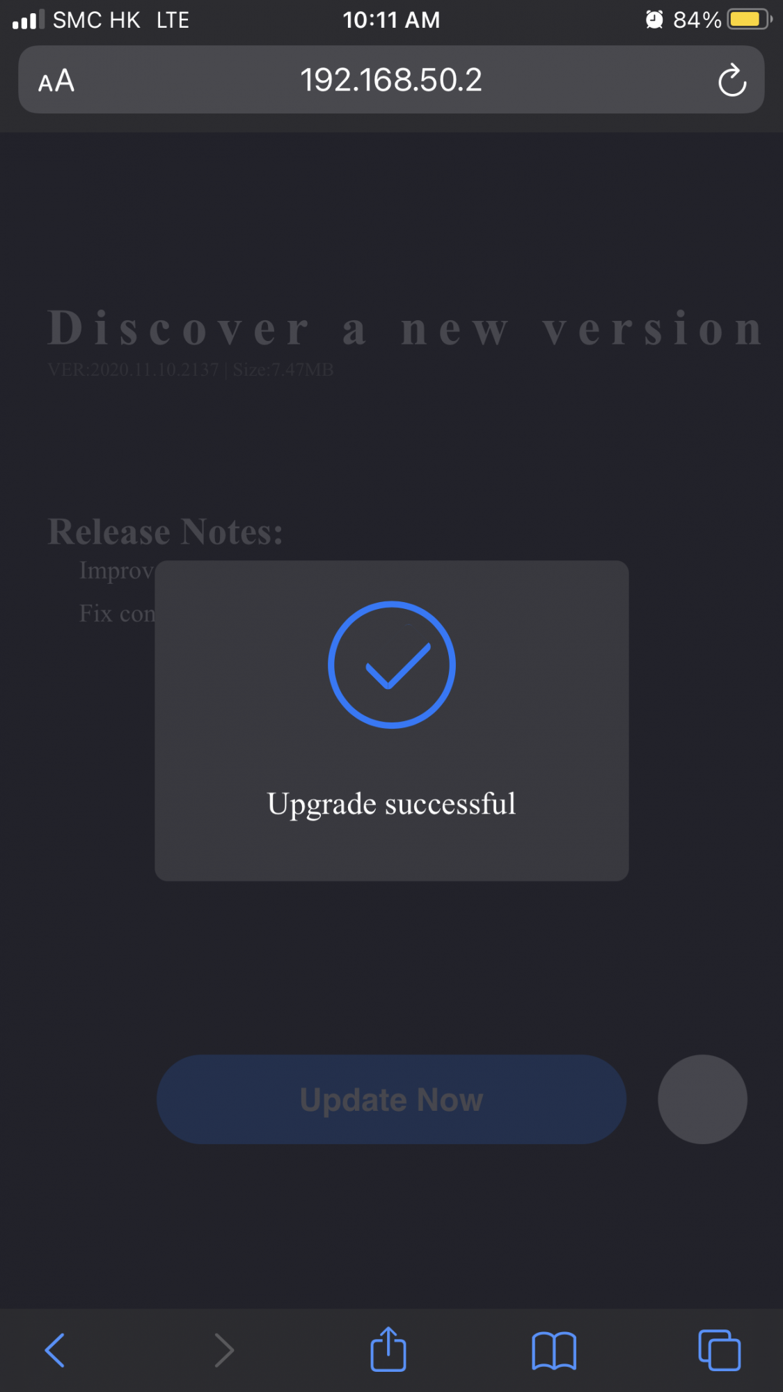

Hi everyone,
Just got some update on my side, I tried OTA update to 2020.11.10 (and it does not work), and then I used OTA to roll back to 2020.08.04 and now I am able to detect the BLUETOOTH and connect to it. The only issue I have is that the Microphone does seems to be Semi-working, I am able to call out Siri, but Siri cannot listen to my voice once it is being called out.
I also see others experiencing the Siri/Microphone issue, not sure if anyone have a solution of it?
Many Thanks!
Many Thanks!
My Bluetooth name is "MAIN M-9F9F" and my WiFi is "MAIN MENU81". The Bluetooth of the Alpine head unit is "OFF".
