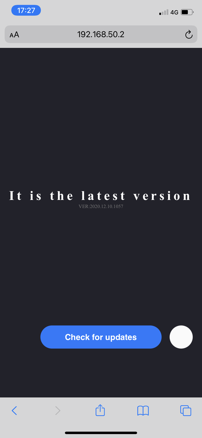

If you are connected to CarPlay, enter "192.168.50.2" in Safari on the iPhone and tap on the large white dot.
