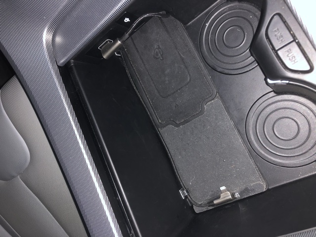

I’ve been sticking with Carlinkit for many months now. Incremental improvements have been promising but it still hasn’t got to the level of speed and reliability on my car to use it with confidence, especially on long journeys. For now I’ve decided to build my own wired car dock and go back to wired CarPlay.
The dock makes it easy to click in my phone (or my wife’s), and does away with messing with cables. The cable problem was what made me want wireless in the first place.
CarPlay appears immediately on the display, with no hanging around for thirty seconds to see if it worked.
Anyway, the dock is made with some plastic and epoxy. It feels robust and I’m pretty happy with it.
