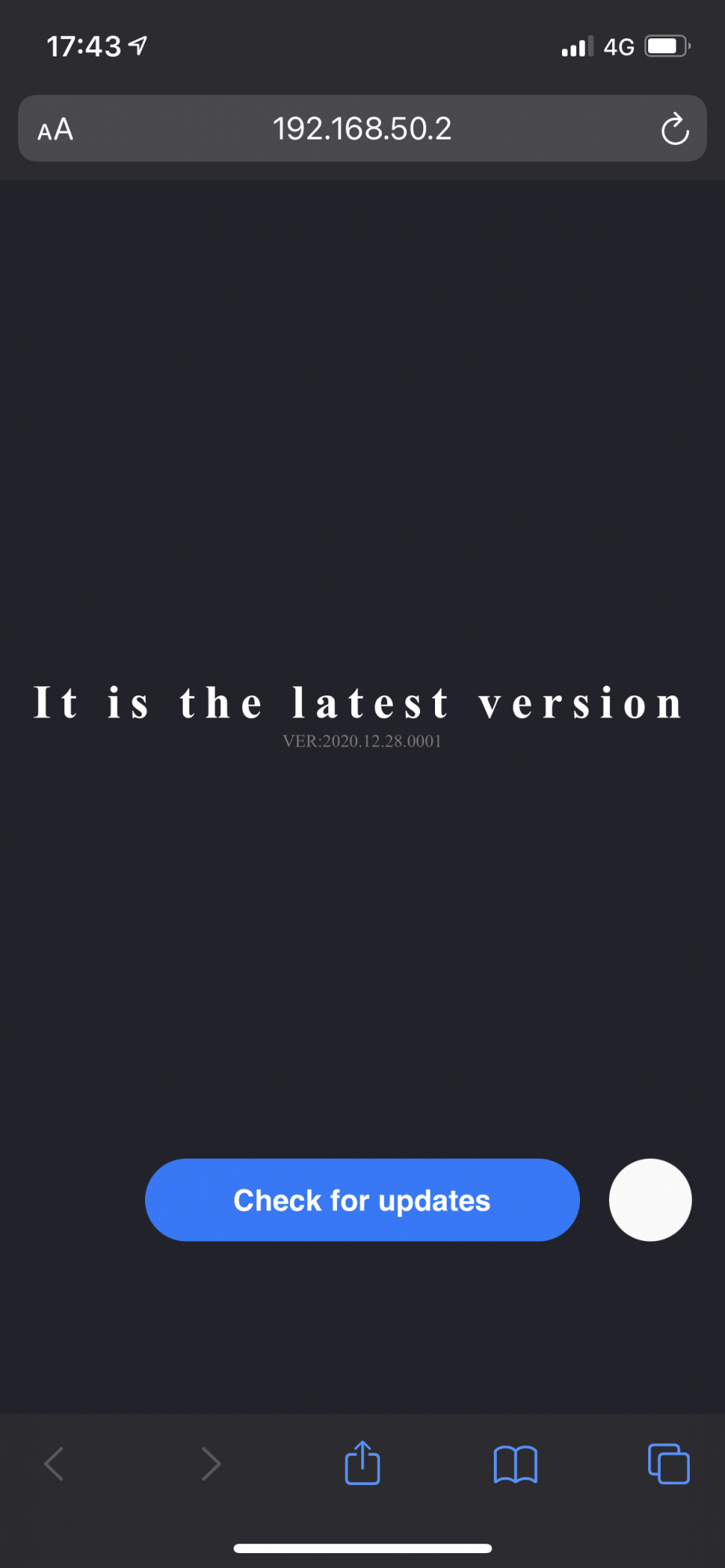

You installed the CFW ? Not the regular December update ? (the version displayed is 28.12.2020.0001 when you are on the CFW)
Hi VLud, yes, it was the custom fw. The official fw was doing the same thing.
I had actually noticed the date difference and was wondering if it was a different version.

It is not a "version" of flash since the flash is the same, it is just the way it is partitioned (and I will not try to expand the rootFS due to high bricking risk), using the custom firmware (any version) you can put U2W.sh at the root of your USB Key with that inside:
Code:
#!/bin/sh
df -h
Plug it on the device, wait 5 seconds, plug it back to the computer and you get the result inside U2W.txt 😉
