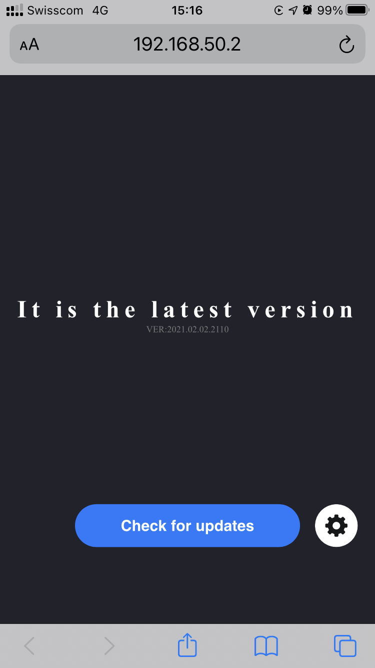

Strange as I have the exact opposite behavior with the 02-02.
Same for me with 2020 C Class: with 01-28 it was starting up to blank screen almost every time, but 02-02 has cured this. However, I could not make OTA update from 01-28 - I used a USB stick. It is possible that clearing the browser cache could have helped but I did not bother to check.
With 02-02 the white settings button now has a cog wheel image. And I tried enabling background mode: the startup screen never bothered me but I do find it tidier to go straight into the CarPlay screen once the iPhone has connected.

I‘m having a carplay2air v1 and flashed the newest firmware 2021-02-02. I wasn‘t long time here to read all the pages. I have the problem in spotify with audio delay 1-2 sec. when skipping tracks. This was on older firmwares the same as at the new one. On the update screen on my iphone i can‘t go in settings at the white Button as some people wrote here to change settings. The only thing i get there is 3 options: save logs, open logs and upload logs. How can i fix this audio delay? Can i do something else? Or must i live with this? This was also the reason why i didn‘t use my adapter for long time and now i think to start again but this delay is nervous. For any help i‘m thankfully. I have a Volkswagen car.
Sorry if my questions have already been answered dozens of times in this thread, but ... well, it's over 200 pages long and I may have missed a post or two ;-) I purchased a Carlinkit 2.0-Dongle for my Toyota Yaris 2020 (Denso multimedia system) yesterday.
1.) What is the naming convention behind the firmware versions? So far, my best guess would be "U2W_Update_YYYY.MM.DD.HHMM.img".
2.) From reading all those posts, it seems like both the Carlinkit- and the Car2Play-Dongles share the same firmwares? What exactly is "U2W"? Are those dongles essentially the same hardware, repackaged in another case?
3.) The first thing I did after connecting to the dongle was to upgrade the firmware. Unfortunately, I did not write down what firmware it originally shipped with, but I am now on version "2021.01.08.1658" via OTA-upgrade. It now says I'm on the latest version. That is of course not really true, with "2021.02.02.2110" being a lot newer. Why isn't it showing up? Is it that they have to manually "approve" builds to be found via OTA-upgrade? If so, is it generelly safer to stick to those instead of manually flashing firmwares harvested through some scripts from their servers?
