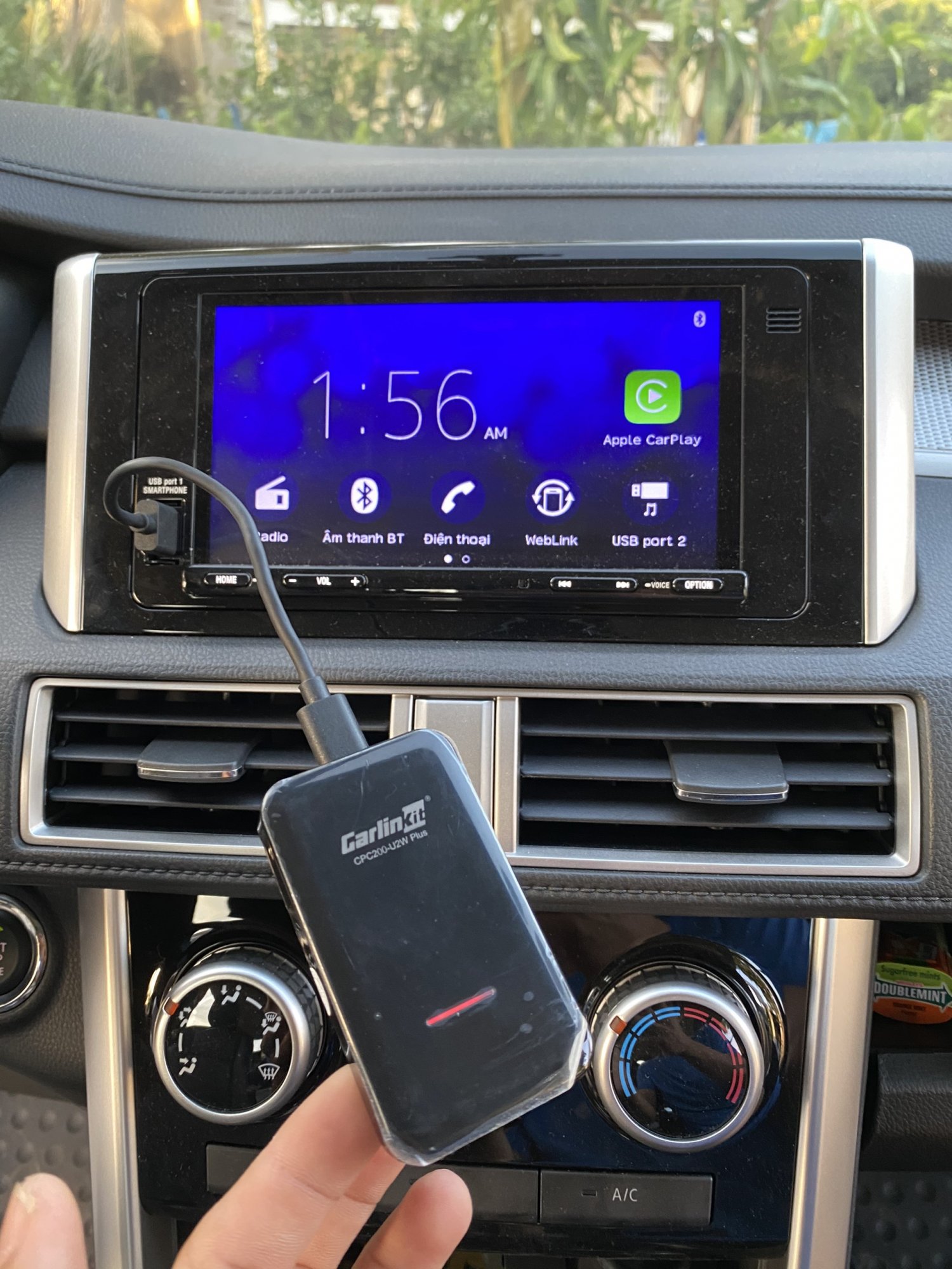

I updated mine to 2021.02.02. It works similar fine to very old SW in my Porsche 718. I hoped it would work on the Sony xav-ax1000 head unit it another can in my family but it does not. The head unit does not repsond to connecting it in any way.

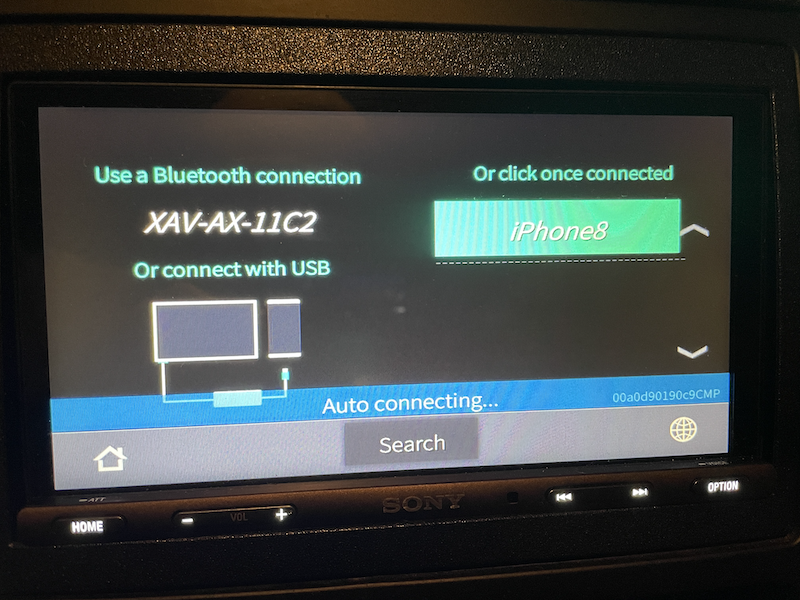

I use a cplay2air with an XAV-AX1000. The head unit *must* be on the older Sony 1.01 firmware. If it has the 1.2x Sony firmware my experience is that the head unit will just go into a reboot loop as soon as the cplay2air adapter is connected. That said, there are some issues: #1 - You can "Hey Siri <ask something>" in a single command and it works, but if you do any Siri requests that require "back and forth" it acts like the mic isn't working when you try to respond. So, "Hey Siri text so and so" prompts siri to ask "what do you want to say" .... but it will never pick up your response. Additionally, the mic doesn't work for phone calls. Other than those 2 (rather large - depending on your use case) issues, it has worked pretty well for me. I personally make due by switching to "speaker" on the phone if I have to make or receive a call, and using my apple watch for more complicated Siri commands that I can't ask in a single request. You can trick the Sony into downgrading the XAV firmware pretty easily if you get a copy of the 1.01 firmware and then rename the file so the Sony thinks it's one version ahead of what's currently on the unit, and by using a hex editor on the first 2 bytes of the file to set the "version" that is embedded there to also be one above whatever firmware version number is currently on the radio. For example, if you have 1.20 installed, you'd rename the 1.01 files to be 1.21, and change the first 2 bytes of the firmware from "01 01" to "01 21".

Thanks for that. That is most interesting. To think we actually upgraded the head unit firmware to latest in the mistaken belief it would be more likely to be supported! We should have tried it first!
We have not experienced the reboot loop though. I plug it in direct to my phone (lightning cable) and carplay works as expected. I then disconnect cable and put in adapter and it behaves as if nothing is connected. The red LED comes on the adapter for a bit and then it eventually goes out. Perhaps if I left the adapter plugged in and power cycled the unit we would experience this.
This was for my son's car. I'll let him know about the limitations and he can decide if it is worth rolling the firmware back. I am an Electrical engineer who has done my fair share of hacking before, so we can work out the tricking of the Sony to downgrade the firwmare based on the advice you have given.
What’s the Cplay2air fw version that works on XAV-AX1000? Tks to let me know.
Version 2020.12.10 finally works on an aftermarket Sony (XAV-AX5000) head-unit.
My aftermarket Sony head unit XAV-AX5110 running 3.0 (then 3.21 on 2.2.2021) was not compatible with version 2020.12.10 as well as some previous and next firmwares. Could you share more details about your exp and your Sony head unit?
