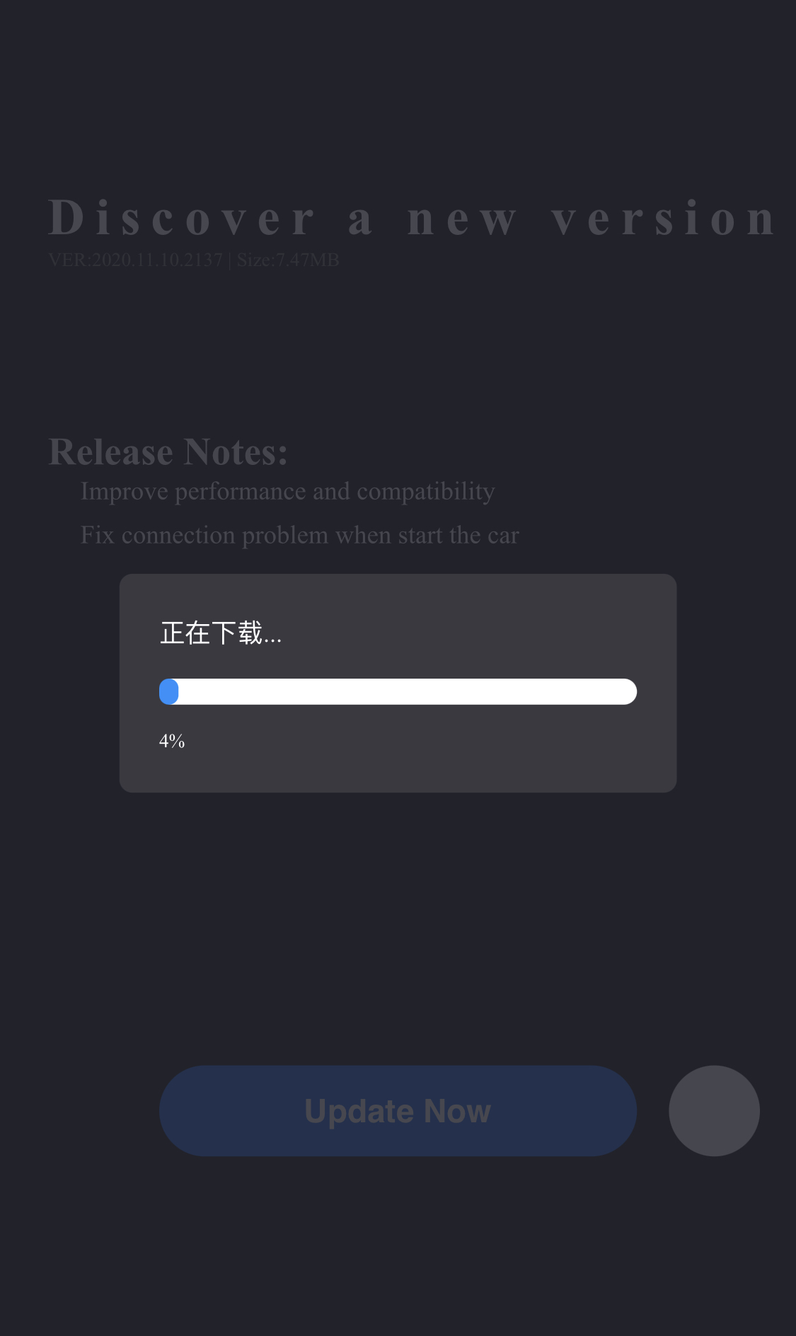

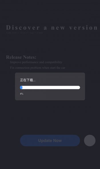

Hi 2019 Denali, thanks for this amazing tip. I just tired it out. I also have 2x adapters so this was do-able for me. First i downgraded to 08-04, but then my iphone could not find the adapter. I therefore upgraded to 2020.09.17. Finally it suggested an OTA upgrade after that.
The upgrade starts after following your list, but it stops at 4%. The iPhone does not connect or start charging at any point.

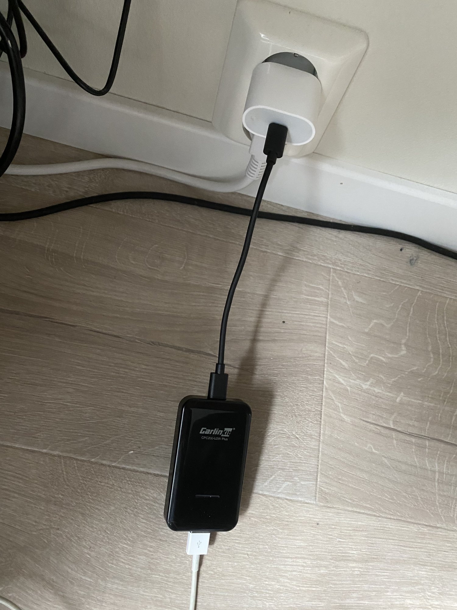

My setup is like this:
USB-C iPad wall charger, usb c cabel from the wall charger to the adapter, then i use a iphone usb-a to lightning cable from the other side of the adapter to the iphone.
Any suggestions? Theres alot of newer firmwares available. I just tried to find one old enaugh to launch an OTA upgrade.

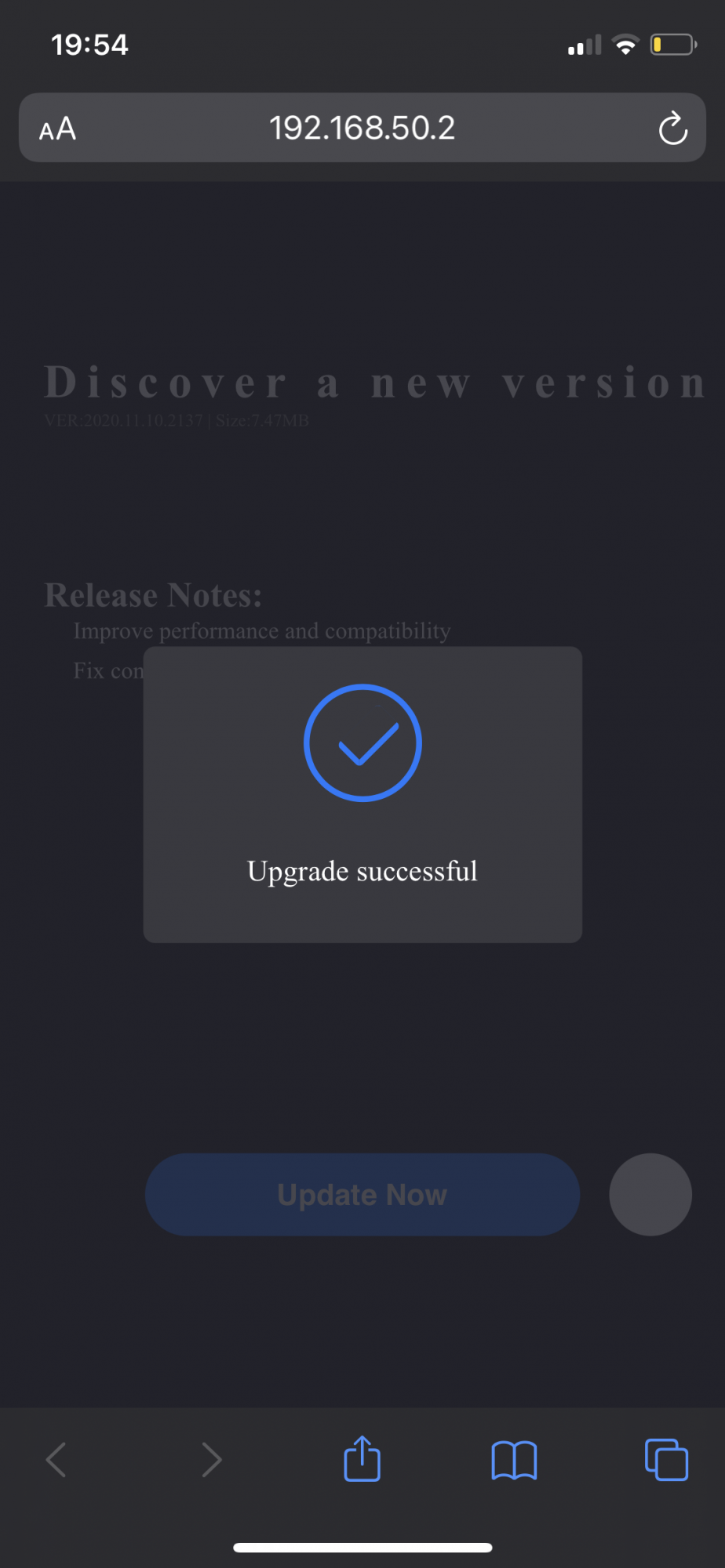

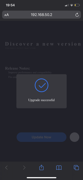

Update, i rolled back to 2020.09.17 to be able to OTA upgrade. The method was a success. I left the bricked adapter it self powered in a long time before starting the process.
But still, no red light or led when powering it.

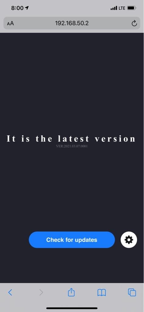

Just downloaded VLud's 2021.02.02 Custom Firmware and did USB update. And the version I see after this update is 2021.03.07.
Didn't see any change from my previous version 2021.02.02 stock.

I think the 2021-03-07 is VLuds custom firmware version that includes the AUTOKIT UI -- which is actually the 2021.02.02 firmware.
Reactions: VLud
Thanks for the clarification. Just downloaded it. Haven't gotten anything to work yet on my Acura so I just keep trying when I see "milestone" updates. The last OTA was a weird one so I'm hoping this is better. I downloaded the AUTOKIT one.
