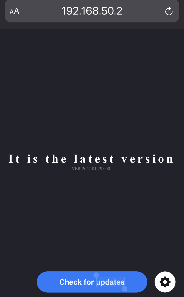

Hmm so i re-downloaded: Because I did not have luck last time getting it take
http://112.74.112.110/mnt//downloads//2021-02-02//U2W_Update_2021.02.02.2110.img
And funny thing is it now says I have 2021.01.29.0001 Not 2-02. Very strange.
I have not done more then made sure it boots up and runs Apple Car Play so far. Very odd Any one else end up with 1.29?

Thanks no its something odd with last build... I re-down loaded Feb 2 build from (site below) from one of our kind fellow posters site and now its really Feb 2 aka 2021.02.02.2110
** So far this Fixes the annoying issue where every other time i run Waze I can't get the search button up to enter an address to go to. Note that all the other apps worked fine Apple Maps, Google. Just waze would be partially functional unless I rebooted the carlinkit.
I actually think the installed version (2020.12.25.1731) may be the issue - it's the same version I have, and I can't install via USB either despite trying several USB sticks, formatting and trying different versions of the update. The other problem is that I can't update to the newest version via OTA either because that version is corrupt and isn't the right size. I've resigned myself to waiting until the next version of the OTA update comes out and hope that works.

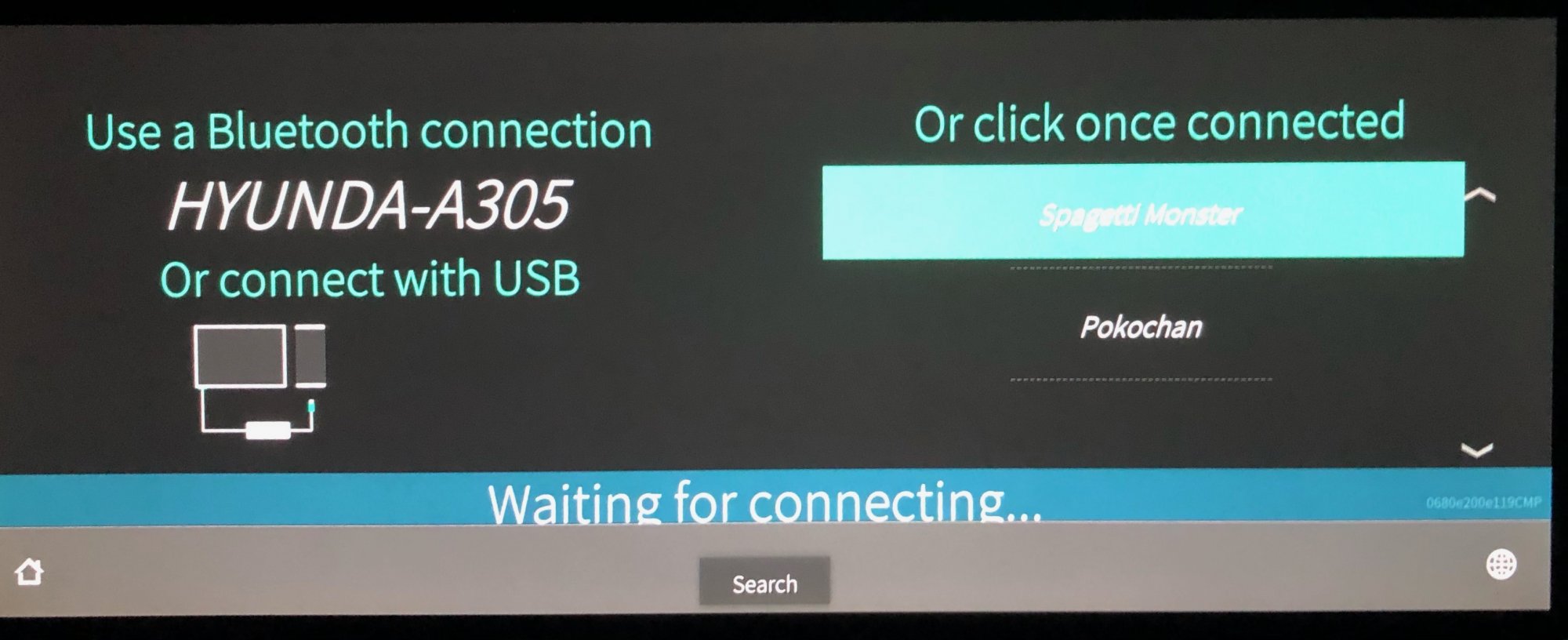

It’s still very lively here🙂. I lost the forum address for some reasons. We are sorting out relevant feedback. If you have good suggestions, you can leave a message here.
Good to see you're here! The recent firmware updates have been really good - reliability seems much better. I have some suggestions though:
1. UI Style : It would be great if the UI for the phone selection screen was prettier. I have a 1920x720 screen in my car, and it looks a bit ugly - the "Waiting for connecting" message is spelled wrong (should be "Waiting for Connection"), and it doesn't fit properly on the screen - the letters are cropped on the bottom. In English the italic fonts look bad, and the font size of the phone names is too small. Also the green button has bad contrast with the white text.
An update to make the UI more consistent with Apple CarPlay would be much appreciated. You can see the issues on the screenshot below.
2. I share my car with my wife, so we often connect different phones. It would be helpful if the "return to car/vendor" button in CarPlay returned to the Carlinkit phone selection screen first. That way if the carlinkit auto-connects to my wife's phone, I can easily switch over to mine.
3. My car has a proximity key, and the Carlinkit USB port is powered as soon as I approach the car. This gives maybe 30 seconds for Carlinkit to boot and be ready for the head-unit connection. However Carlinkit doesn't seem to start until after the head unit boots. It seems that Carlinkit could boot earlier, to improve connection speed?
