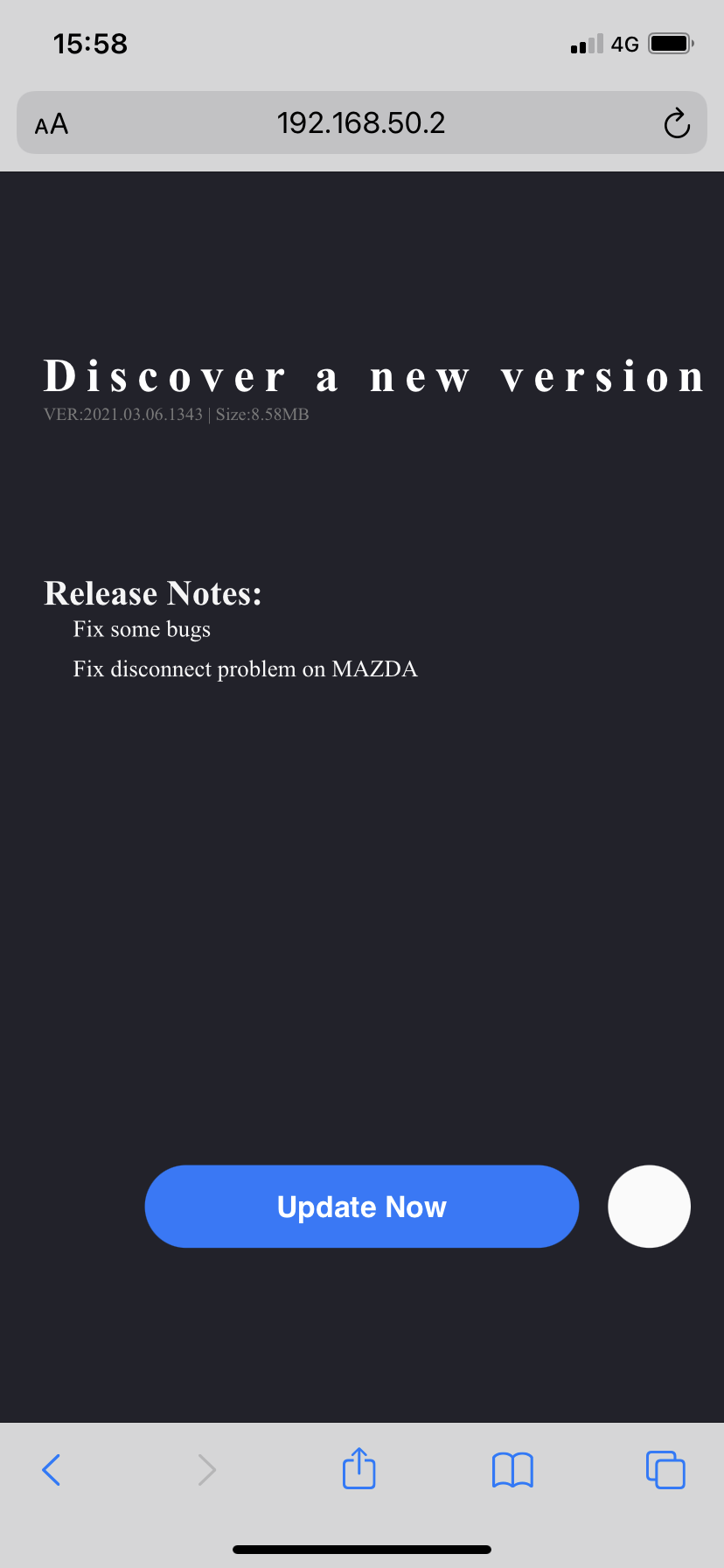

I was also looking for an answer to this please
