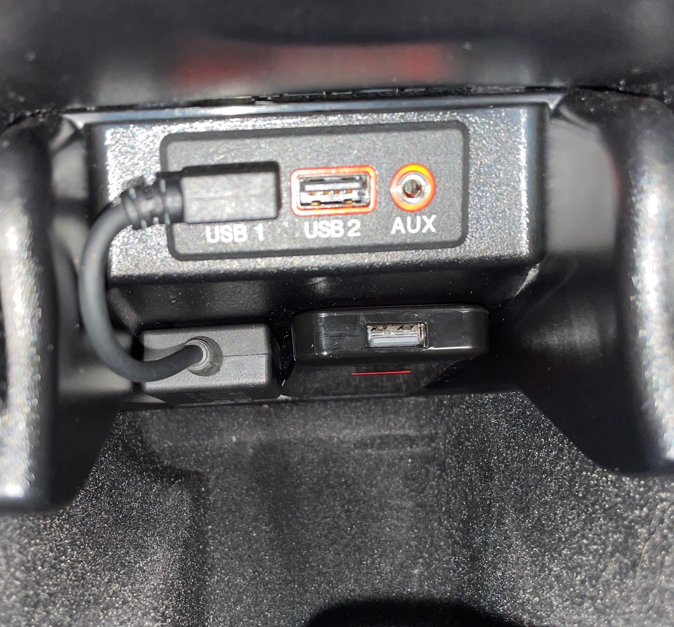

Here is my first (old) solution:

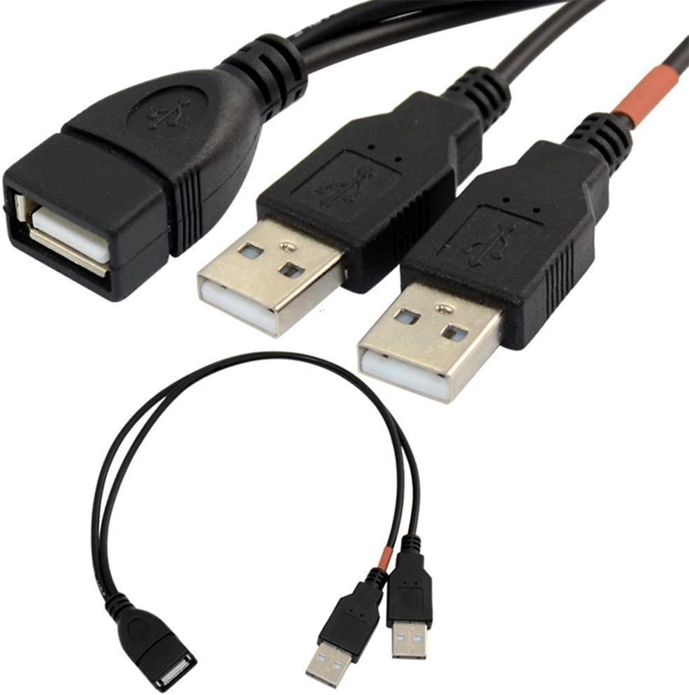

Using USB 1 and USB 2 ports in the Maxima with a y-splitter cable.
I installed this and tucked it all away in the small front compartment and it worked without any issues for about 2 weeks before I implemented my second solution.

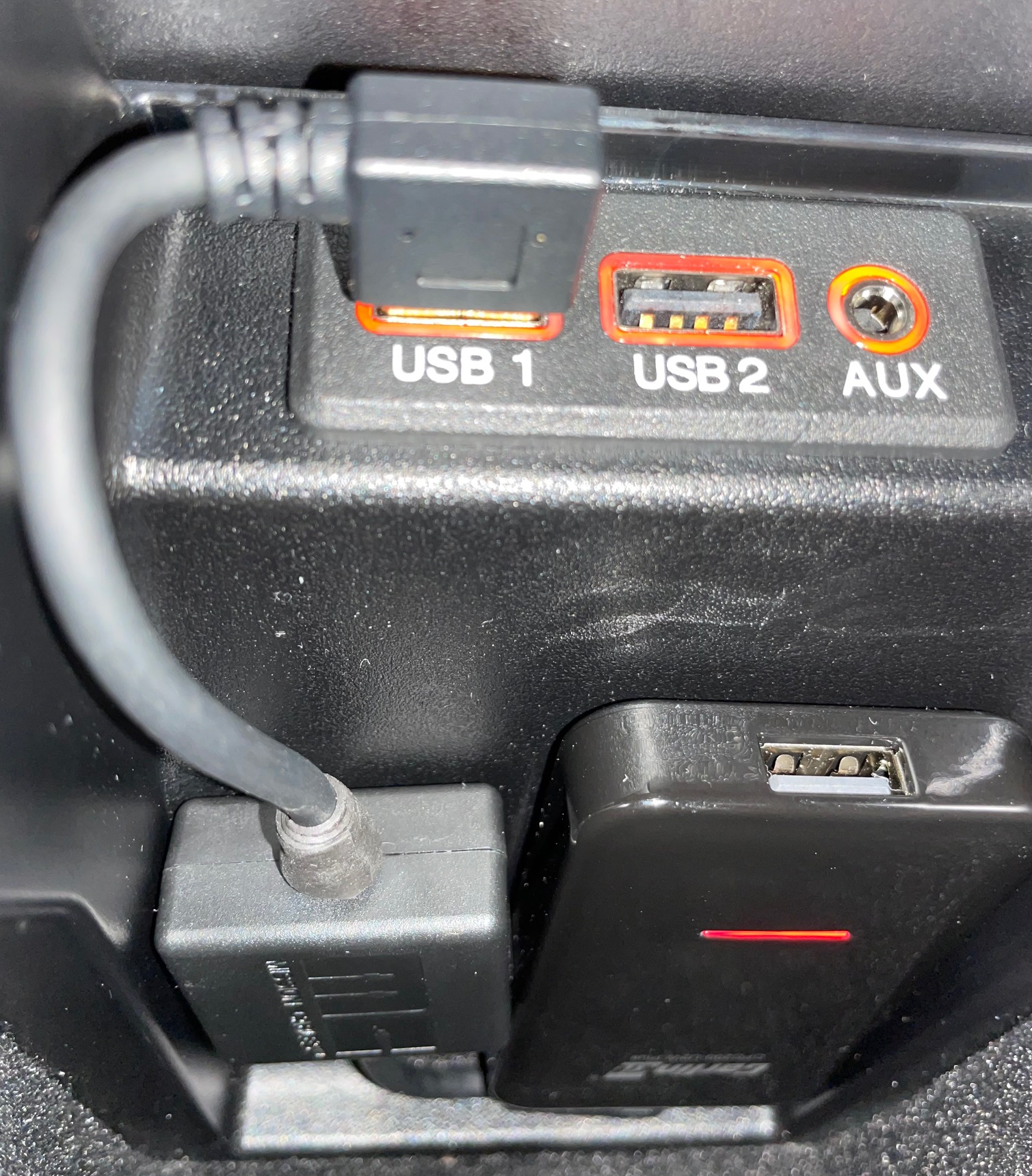

Here is my second (current) solution:

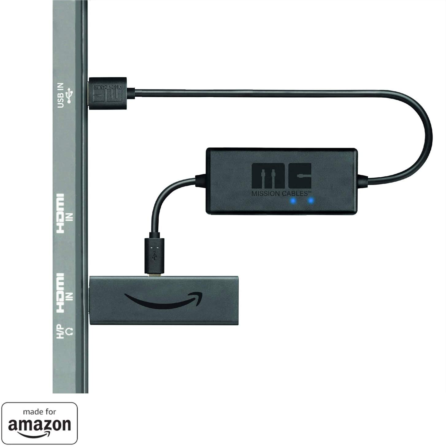

I tried ordering a Mission Cable for Amazon FireTV from Amazon:
However, this was way too large and provided power only and no data connection. Next, I ordered this older Mission Cable which is much smaller and uses 2 capacitors instead of a battery. (Note the model number)

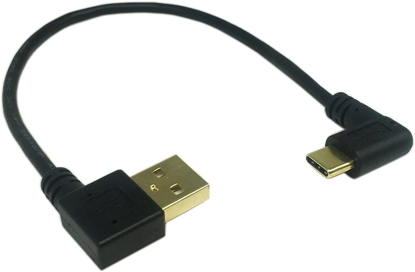

The problem I had with this was the same as the first, as it offered only power connection. I ordered this angled USB-A to USB-C cable with data for the Carlinkit 2.0 (with USB-C connection).
I removed the case for the Mission Cable capacitor and removed the USB-A and Micro USB red/black cables. Then I sliced open the sheathing of the cable. I did not cut the cable, only removed the outer rubber and left the data connections in tact. I cut the red/black power cables and soldered them to the inside of the Mission Cables board.
What I was left with was an angled USB-A to USB-C cable with a small MC cable in between. This worked perfectly in my 2017 Nissan Maxima. The Carlinkit remains powered on about 10 seconds after it is turned off or unplugged. Unplugging the device for 10-15 seconds shutdown the device completely.
