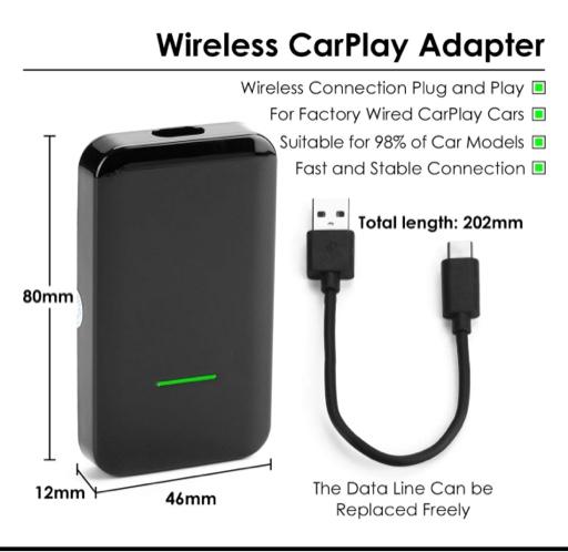

I have the original CarLinkIt v1 dongle and it’s working ok in my car, the one that looks like this...
However I’ve seen what looks like a copy/3rd party in Amazon that looks identical as the CarLinkIt v2 type, it says same size, removable USB-C cable, same 192.168.50.2 for updates etc. Pic of the one I’ve seen is below.
It’s very cheap, and wondering if I should buy, even for a backup etc. Is there any point in getting this v2 if my v1 is working anyway? Is there any benefits of the v2?
Has anyone had the v1 type of any of these dongles and bought the v2 and found any difference in anything.

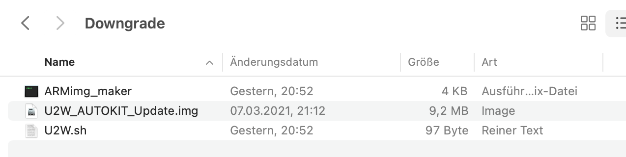

The USB stick has to contain this, check the file size...:
I appreciate the help, but still not working. I double-checked all the files on my USB and they match yours. I even clicked "RESET"... said "Are you sure?" said "OK" and nothing. It's really bizarre. I don't get why this isn't working for me. So frustrating.

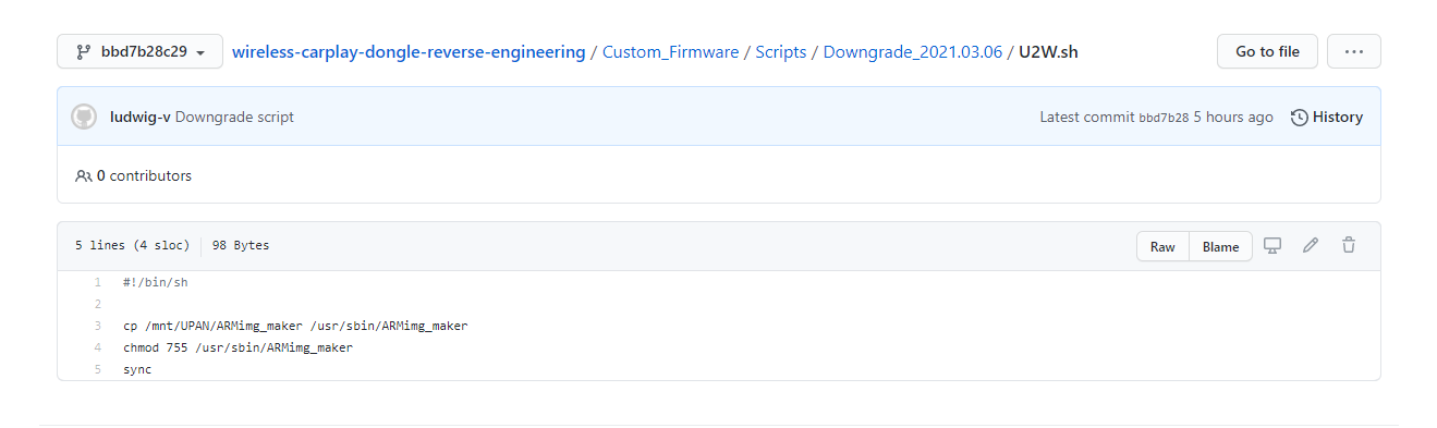

Content of U2W.sh should be:
You should get U2W.txt created when the script is executed, if not the USB Key is not correctly created, send us a screenshot of your USB Key files to confirm
Oh boy....thank you @VLud *I* am a moron! My U2W file had alllll sorts of extra stuff in it. I copied/pasted the RAW file info from your repo and everything worked RIGHT AWAY! I downgraded to the August FW and can confirm that Ford Sync's steering wheel button does indeed work. I appear to be down now on the green/blue boot interface rather than the Autokit (even though I used the CFW) but at least I can use my steering wheel voice controls.

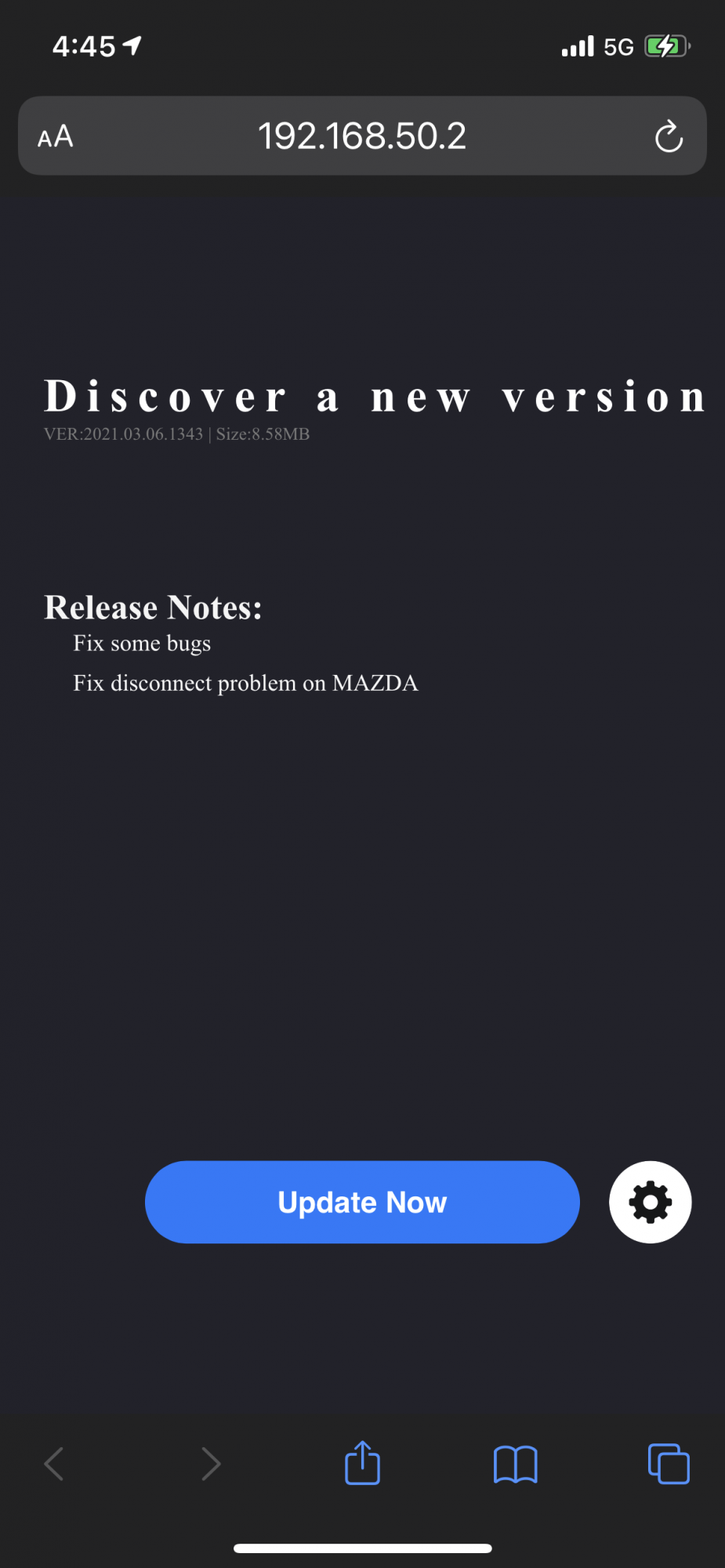

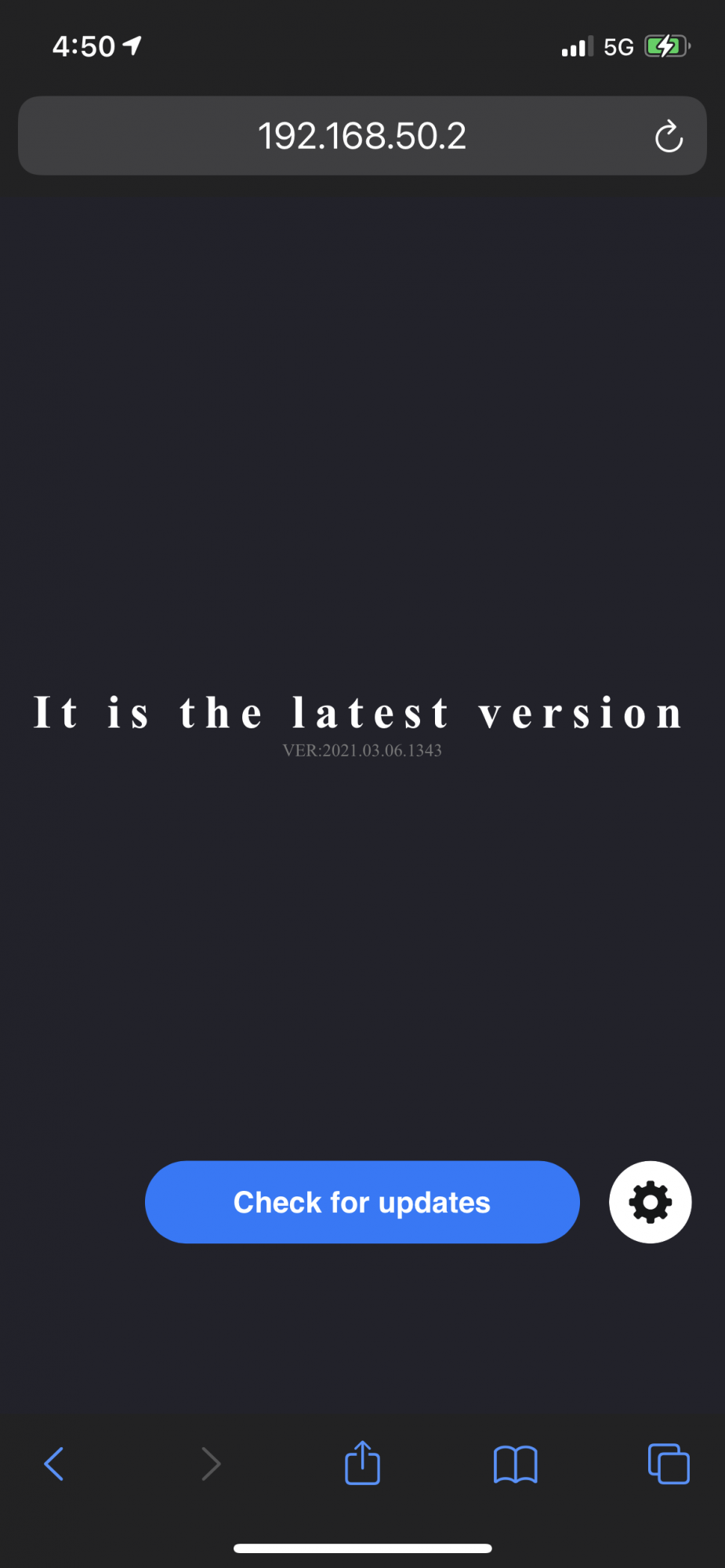

I want to share this information with MAZDA owners. I was on the known working 2021.01.28. Today I brought up the 192.168.50.2 page and it showed that there is a new version 2021.03.06.1343 to "Fix disconnect problem on MAZDA". I decided to let it go ahead with the update in the car because I know the 2021.01.28 would not reboot every 30 seconds. It should be able to finish the update with the car power.
It updated and rebooted itself. Looks fine.
I know the 2021.03.06 image has been out for a few days and people have been talking about it. Just want to let MAZDA owners know that this version works for me.

I also upgraded from the 2021.01.28 (which I had tried to upgrade before to the February code). The upgrade appears to have gone fine, and my Mazda is as happy as before. I may stick with this code unless I am tempted by a nicer boot screen 🙂
