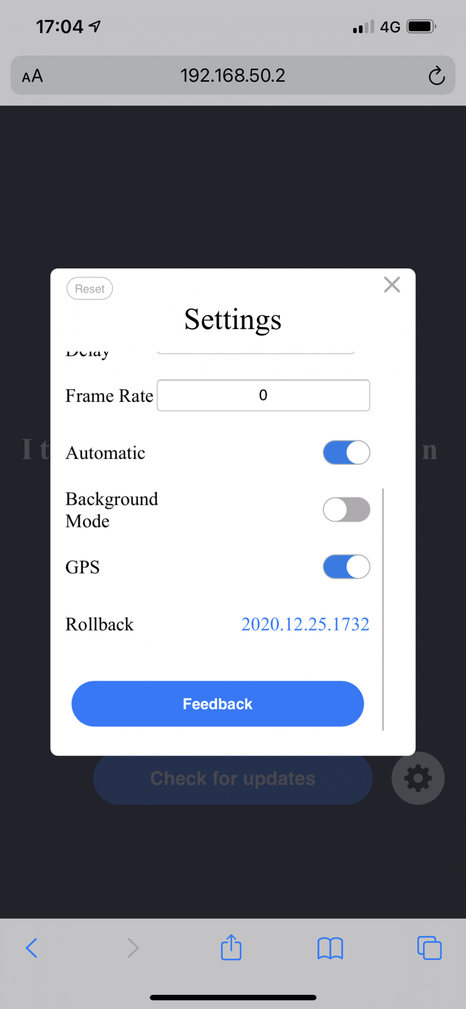

Did you try the Roll Back option under the gear Icon with other settings?

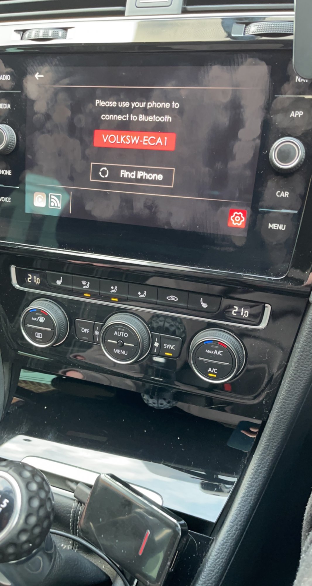

Please ignore the dirty screen, but I finally received the £30 dongle off Amazon, and I could swear its just a CarLinkIt, but for some reason, £100 cheaper! Working ok so far, although it took me a moment to realise that it had to connect to Bluetooth and WiFi!
Im curious about the settings though, has anyone figured out what they all do?
Also, silly question, can I ask what Vluds CFW actually does, are there any advantages to keeping it stock?

Please ignore the dirty screen, but I finally received the £30 single off Amazon, and I could swear its just a CarLinkIt, but for some reason, £100 cheaper! Working ok so far, although it took me a moment to realise that it had to connect to Bluetooth and WiFi!

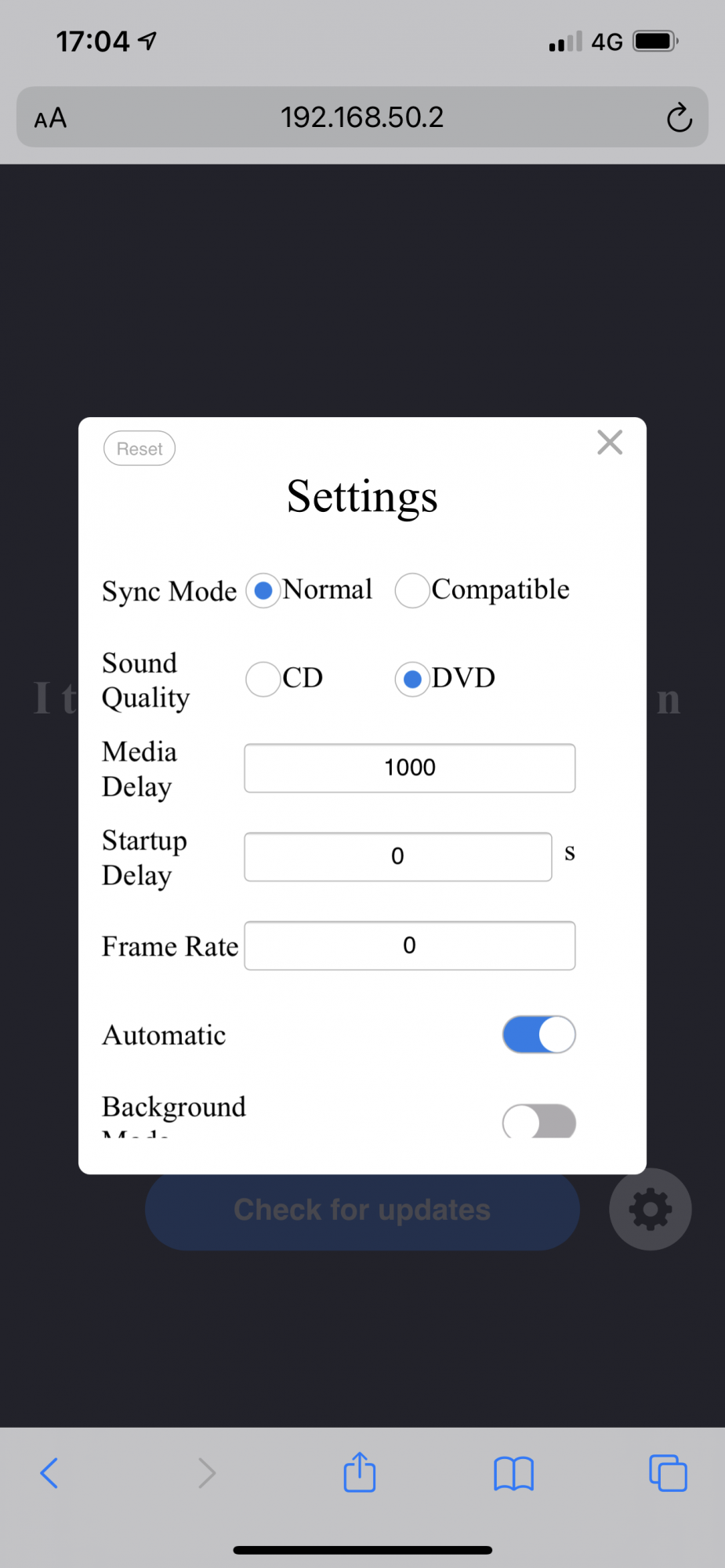

For normal users, no difference. The CFW allows the running of scripts and a nicer connect screen. Goto the first page and look at what those options mean.
That's great, thanks! I'll go for a drive later to see how it manages, only plugged it in and connected to try it out so far.
Do we know about Frame Rate = 0, if this changes anything?
Nice GTI! Looks like a Mk7.5 Autobahn?

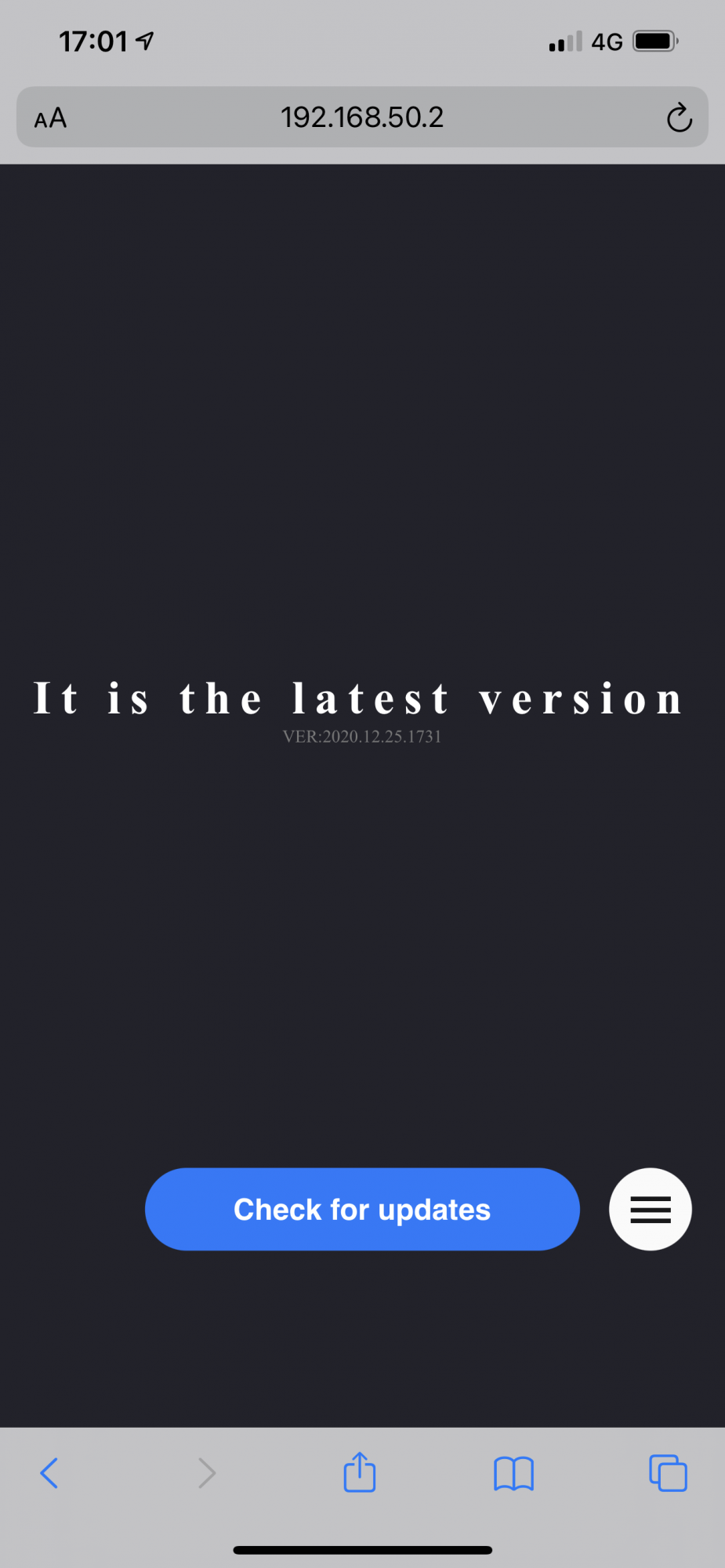

Received the $45 device from Amazon today. Hooked it up to a Mazda CX-5. Initially nothing happened but the "CarPlay failed" message. Connected to the device manually on WiFi and brought up the 192.168.50.2, it indicated that there is a 2021.03.06.1355 for Mazda. Note: My CarLink 2 received the 2021.03.06.1343. Took the OTA update and upon the reboot, established a connection via Bluetooth. Done! Now my CX-5 and 3 each has its own wireless CarPlay.
