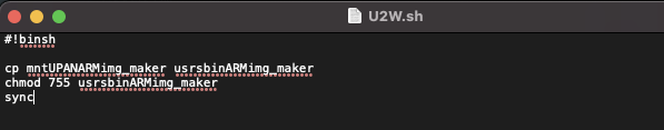

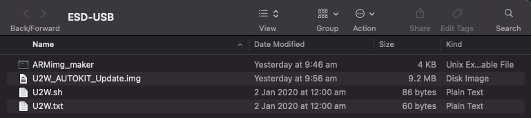

Ok, I checked all my files. It turns out I had U2W.sh.txt so I deleted the .txt and it worked 🙂
Thank you, you guys are genius!

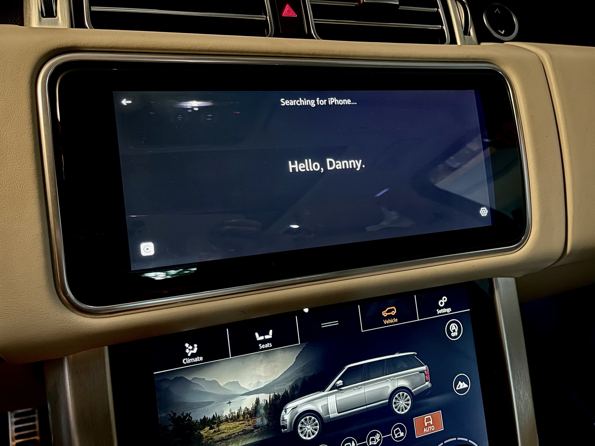

Here's my personalized interface to match my vehicles UI fonts and design language. Thanks to @VLud for making this all possible. I was using the MMB, but given I can customize the U2W based dongles, I'm switching back. I'm using the Car2Play dongle because for some reason, the touch response is better in my vehicle vs the Carlinkit CPC200-U2W Plus. Not sure why the two would perform differently using the exact same firmware.
@Mavro - looks clean! Would you mind sharing your modified ui.tar.gz file and give a quick rundown of the steps you took to push it back to the device?
