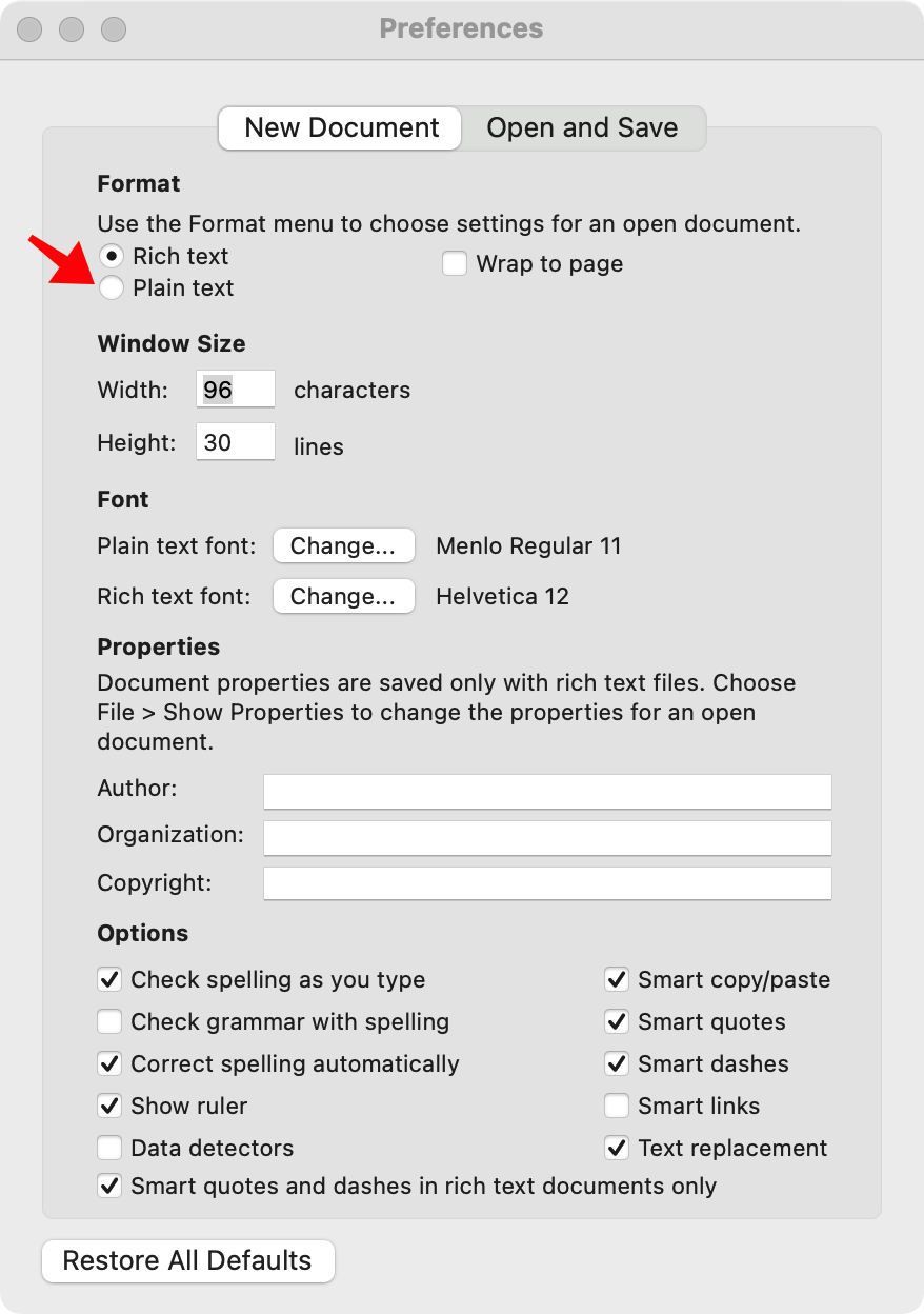

MS Word will definitely mess that up. You must use Text editor I suggest Notepad++ it’s free
Even saving as a plain text file? There’s no metadata that I can see viewing the file in another app.
Unfortunately Notepad++ is not available on Mac, curious to what others are using on Mac to create a plain text file.
TextEdit (at least the one I have on my older Mac) does not have a Plain Text option for saving. It's RTF format adds a whole lot of metadata to the file when I rename it.
Change to Plain text and then open a new file
Use TextMate, it’s awesome. Perfect alternative for Mac.
