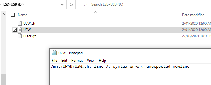

Hi @TireGuy6, I have copied the 2 files and plug it in my custom march firmware device but the red light remains red and nothing happens.
Then I plug the usb back to my computer and it created an additional "U2W" file with the error below.
Any idea why this is happening?
EDIT: This is now solved.
I opened up the U2W.sh with notepad and there were a lot of code before the script. I deleted the rubbish and copy the raw script then save.
It installed and now working 🙂
