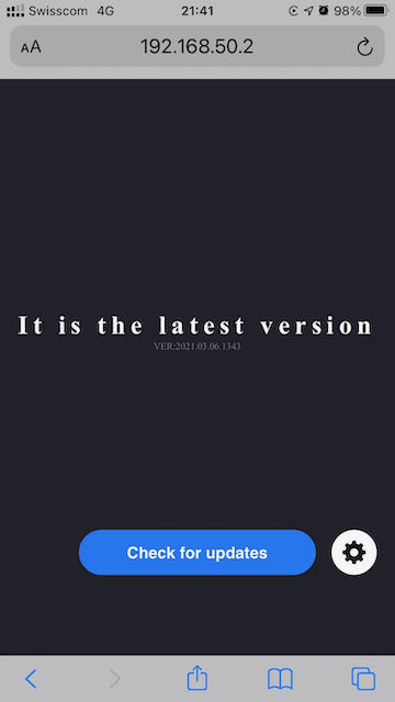

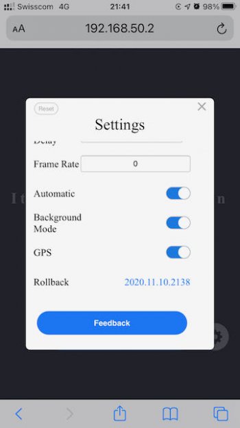

Went to my car to get the two dongles just now. The stock 2021.03.06 still has the rollback option but the custom one does not.
You dont need a roll back option in custom firmware.
Ludwig has provided a script to roll back from March. Add the U2W.sh script + old firmware (U2W_AUTOKIT_Update.img or U2W_Update.img) + ARMimg_maker on USB and roll back.

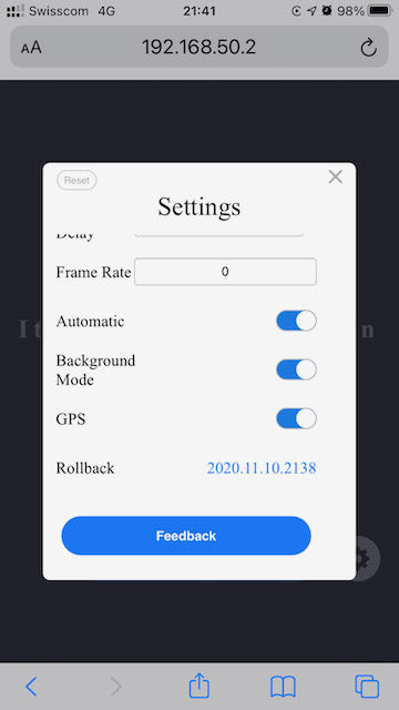

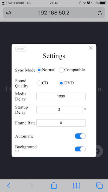

I have tried but it's failed. maybe they don't want us to rollback.
EDIT: modified comment as illustrating that I still have downgrade option from 2021.03.06 is not actually helpful.
I am instead going to follow directions from @TireGuy6 and roll back to November firmware, then install Autokit and try his UI.

Hi,
No you cannot use original firmware with my theme and you must flash to custom.
Custom will allow you access to roll back if you need to, as you can see they released a version with no option to roll back. This killed some devices when they changed the WIFI driver and people are SOL and have a dead device.
If you have a Custom firmware you can roll back, not to mention to CPU performace is increased, and logging is disabled to save RAM 3+ features in custom FW.
If you are on a March 2021 release, with ROLLBACK option in http://192.168.50.2 - USE IT and downgrade to ANY original version and then UPDATE to a CUSTOM FW, FEBRUARY 2021.
