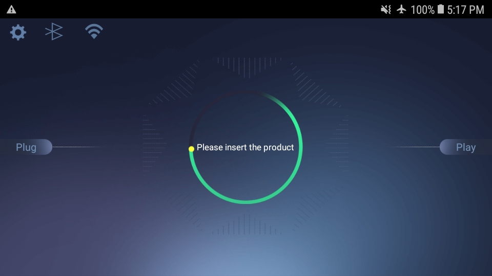

On another note "AUTOKIT" is also the name of the app used on Android and WinCE Headunits for Carlinkit CPC200-CMAP [wired carplay and AA] and Carlinkit CPC200-Autokit-Pro [wired/wireless Carplay and wired AA].
*** this is the Autokit app interface for Android/WinCE headunits that do not have Carplay/AA from factory***

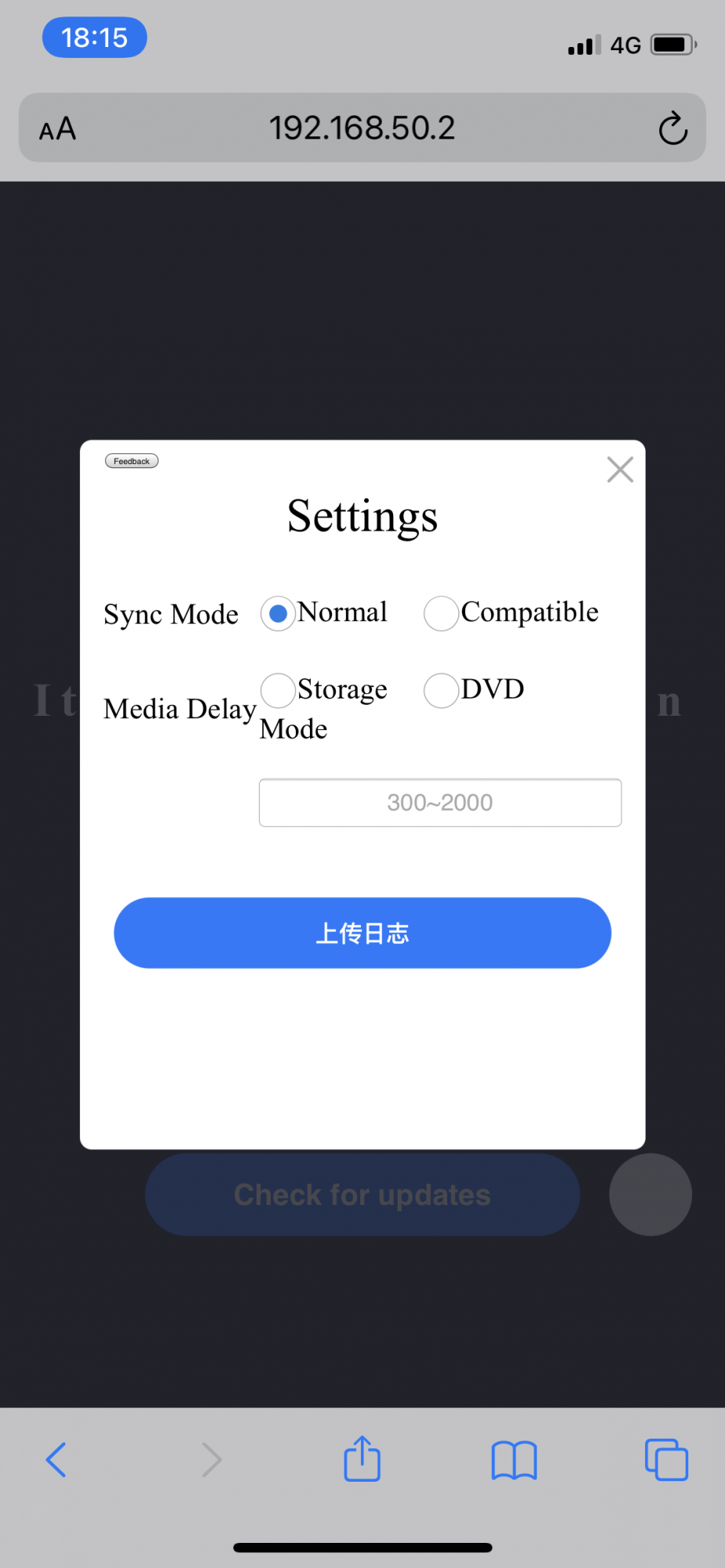

hello I bought the carlinkit u2w + after an update it remained red and no more connection I can no longer access the site 192.168.50.2 I received a firmware that I put on a 16 gb usb key formatted and renamed the file and nothing happens the light remains red can you help me sorry for my english

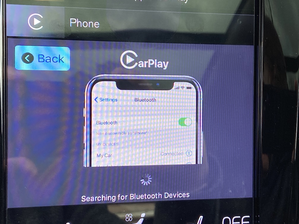

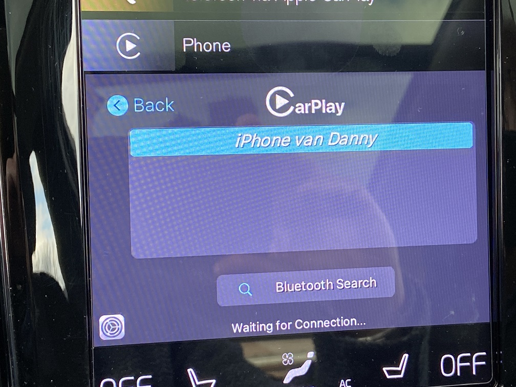

One question is it possible to change the word "Phone"at the top in eg Iphone Carplay or Iphone from "naam".
Also, it's weird that your listboxes and BT search are not centered properly.

Hi,
That is part of your head unit / from your vehicle manufacturer.
I can only control elements within the grey background.
Ok, but if I connect my Iphone directly with cable at the Carplay , the top is mentioned as my first photo "Iphone van Danny" so probably the name "Phone" is stored in the dongle?
That is lists of connected devices, this is pulled from your device. Settings > General > About > Name

Now, 'Phone' that is pulled from the dongle. The dongle emulates an Iphone being connected. My U2W cays 'iPhone' your CPLAY2AIR must show 'Phone' Either way it can't be changed without modifying system files on the dongle
Yes this stored in the dongle. It will not pass the real device name. I am investigating how to change all these names but it seems like its hardcoded in the binary,
