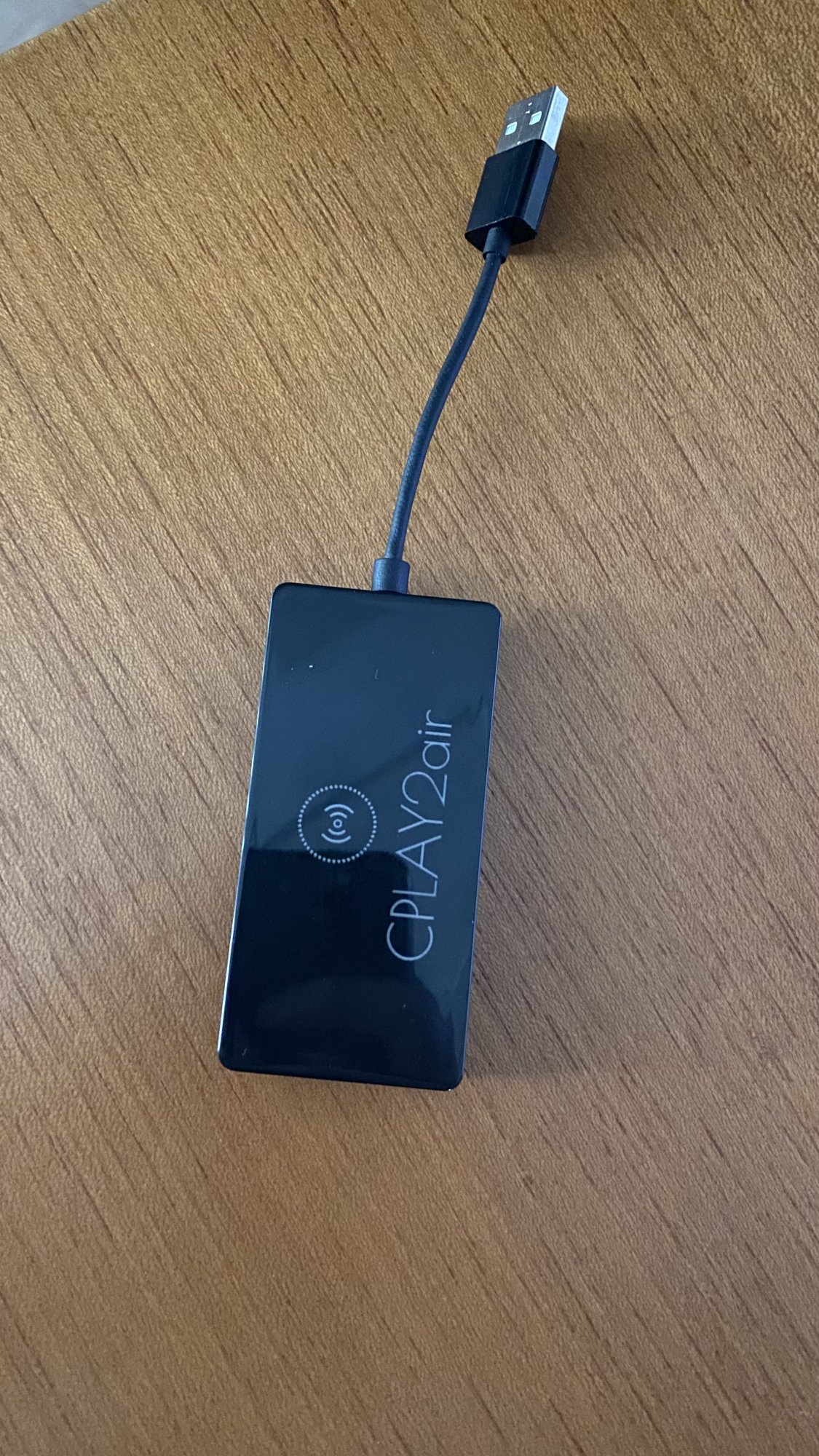

Got a CPLAY2AIR and it worked for a few minutes, then it stopped completely. Neither of its WiFi or Bluetooth networks show up anymore. Has anybody had any problem like this? It's essentially bricked and I can't even connect to it anymore.
Does the LED light up, and if so what colour? If no light then your device sounds like it is dead.
Thank you for answering.
It lights up briefly in the green color when connected to the car or a power brick. I've also attached a picture of my model.
I have this model. The RED LED should stay lit. If it's not staying lit when plugged into your car, the outlet might not be providing enough voltage.
Try plugging the dongle into an iPhone or Samsung power brick to see if it stays lit when plugged in to there.
EDIT: Sorry I meant RED LED.
Reactions: ticruz
Plugged it into my iPhone's charger and no success. Only the green LED shows up for a second when I plug in, then it goes off.
Sounds like something is up with it. Maybe try a USB flash, otherwise I'd reach out to the seller about this to start that process.

Thank you for your effort. However, it is not working for my bricked device.. (Hardware error: Wifi)

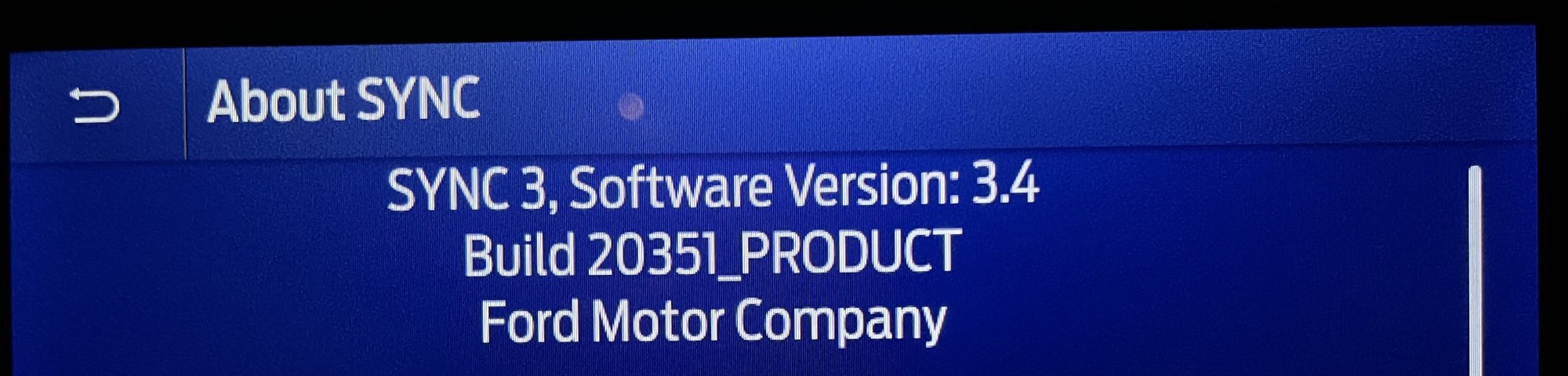

Not sure how much it helps the Ford sync people in the US as for some reason mine has always worked out my UK but I checked the Ford sync update site recently and there’s been a new build released for my car.
Siri still works with the adaptor but maybe worth a shot for some!
Thanks - what build of SYNC are you on now? I'm on 20136 which was released for my vehicle about a month ago.
