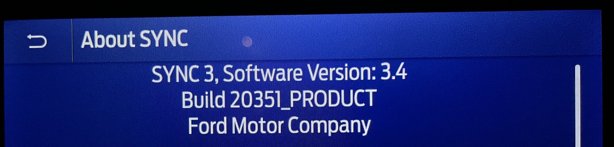

Mine is 20351 - with adaptor on custom fw 2021.03.07
I don’t think that ones been released for the NA market yet. Been following another forum on updates for Sync. Strangely, even though 20282 was delivered to me via the Ford website just weeks ago, it’s suddenly no longer available. You’d think Ford would notify those who updated if there were any issues. No wonder Carlinkit can’t keep everything working! Ford has a lot to do with it I think LOL. Guess I’ll stay on 20136 until I hear otherwise!

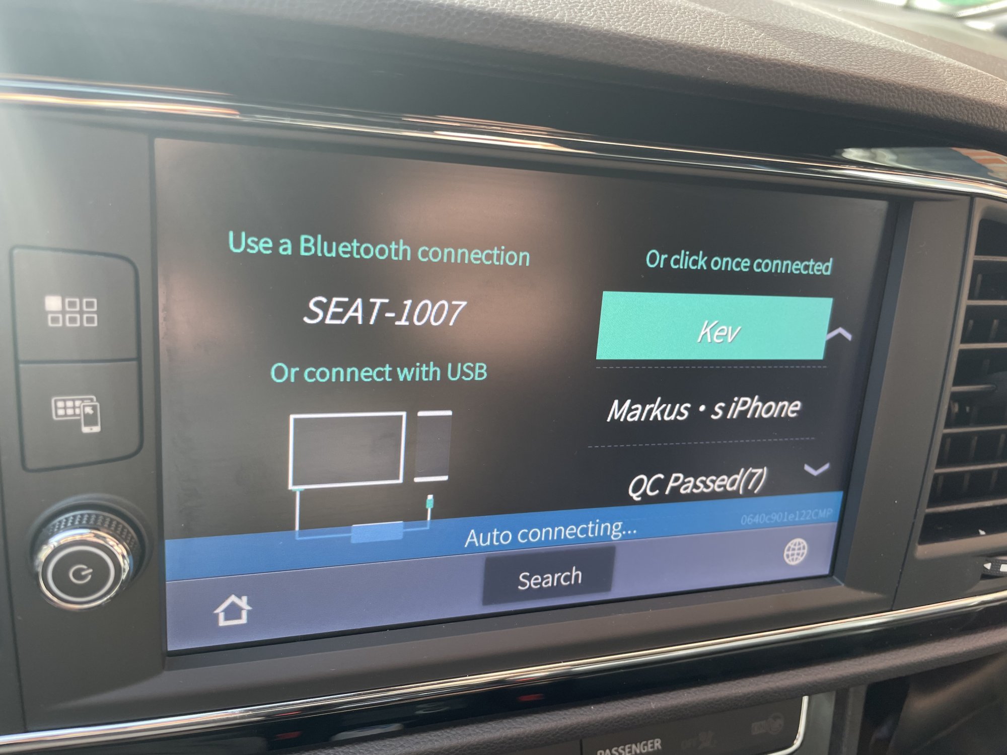

Im on 06.03 cfw now. But don’t know if I have red or blue GUI as I’m colorblind 🤦🏼‍♂️
seems blue :D
