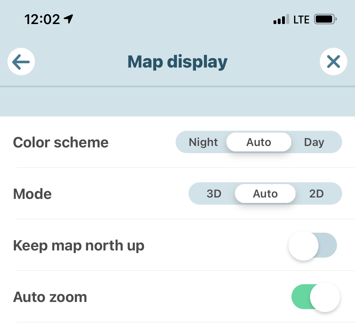

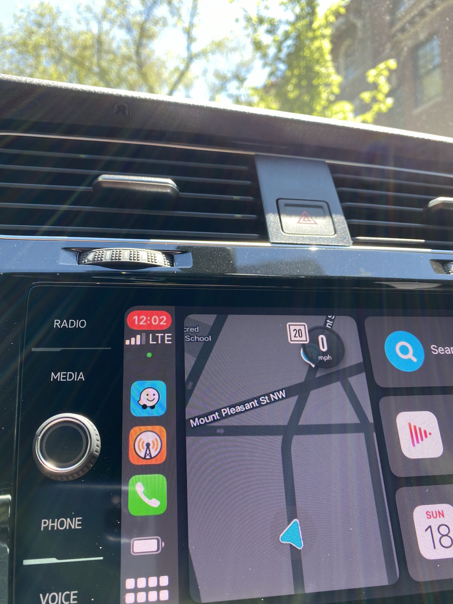

Behold dark map Waze in the middle of the day in bright sunlight, headlights off, appearance mode set to Auto. Again, I'm pretty sure Waze is going off of CarPlay's interface mode (light vs. dark) because if I switch CarPlay to light mode, it turns light. Switching Waze's mode manually to Day also works but that's is obviously not ideal. Keeping CarPlay in Automatic isn't my favorite either since the light mode contrasts to heavily with the black/dark radio and trim in my GTI.
