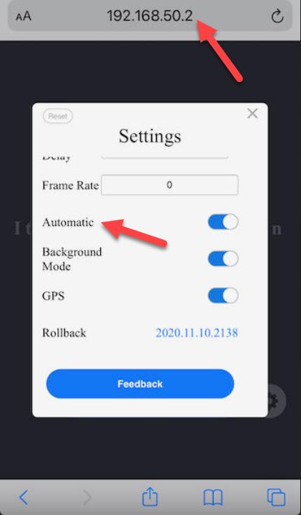

Is there a way to disable auto-connect? We use it with 2 phones and the carlinkit always tries to connect to the previous device. I'd honestly rather it just didn't auto connect. Is there any way to disable it?
If you turn off bluetooth on both phones so it doesn't auto connect, you can click the settings button on the Home Screen before CarPlay loads, and this gives you the option to turn off auto-connect.

I've spoken with the factory and they have advised to please go to 192.168.50.2 and change the setting to compatibility mode, set start up delay to 2 seconds and please report if stable? Please can you confirm if you are using Green UI or Red UI

Just a reminder that if you do not see the web page inclusive of the cog wheel icon for the Settings then close the browser, delete the cache and try again.
Ah on the carlinkit dashboard? I will give that a try!
Edit: Ok what do I need to do to get the settings button? All I see is the home button and language selection. I’m running 2020.11.10.2137. My web interface says that’s the current one. Not sure how to get the March 2021 update.
I think that must be in a newer firmware. Mine doesn’t have that. But when I try to update it says I’m on the most current one.
I keep trying the USB update method to the March 2021 update but the update never takes. I get a red light when it power on but it never starts flashing after I plug in the USB drive.
edit: Finally got the update to work via USB. Now I'm on the March 2021 firmware and see that option. I was able to disable auto-connect and everything works just as I hoped. Thank you!

For future reference, you often need to close the browser and delete the cache, then connect again before checking for updates or even in some cases to see the enhanced settings options.

its been an option for last ~10 updates , some tine its just a bug with a browser..
