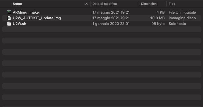

This is the screenshot of my usb that saved me, ARMimg_maker and U2W.sh are from here (https://github.com/ludwig-v/wireles...Custom_Firmware/Scripts/Downgrade_2021.03.069) and U2W_AUTOKIT_Update file are from here (https://github.com/ludwig-v/wireles...ster/Custom_Firmware/2021.03.06_BASED/AUTOKIT), insert the usb and if green and red light flash the update is installing and wait until the solid red light are bacth
lol I got lost until I realized the first link you accidentally added a 9 instead of just 06

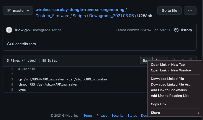

Question how to download the sh file since there is no download option like there is for the arming file?
Thanks
I had the same question and I solved it below
- Open file
- Choose "Download Linked File" on "Raw" with right click

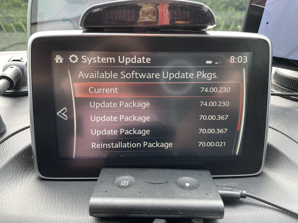

TO ALL MAZDA OWNERS: DO NOT UPDATE YOUR INFOTAINMENT FIRMWARE TO THE NEWEST 74.00.230A. I updated it and now my wireless CarPlay (March firmware) is no longer responding.
After updating the Mazda firmware, my adapter would sometimes be non responsive. Sometimes I’d get a “CarPlay failed” message on my monitor. Just recently, my left speaker stopped working and I thought it was weird timing with the Mazda firmware update. I tried playing with the audio settings and nothing helped. As a last minute ditch effort, I factory reset my infotainment system. That somehow fixed my speaker issue.
Now my CarPlay adapter is no longer recognized by my vehicle. I deleted the WiFi and CarPlay from my phone. Every time I connect the adapter, the red light shows up and the WiFi still appears but the car doesn’t bring the device connecting page anymore. I’ve also tried downgrading the adapter and reupgrading but nothing brings back the red black device connecting page.
One thing I haven’t done yet is downgrading my Mazda firmware back to 70.000.34. Which at this point I’m way too lazy to do.
I updated my 2015 Mazda 3 to 74.00.230A last Saturday but I didn't get on the road until Monday. It was actually alright on Monday but this morning is completely NO NO. Black screen at all times no matter how many times I rebooted the Carlinkit2.
Glad to know I’m not the only one experiencing issues. Do you think we are able to downgrade our firmware for the infotainment?

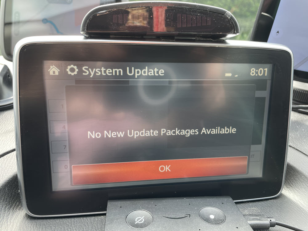

Possible! When I inserted v.59 collections, it didn't find anything.
When I inserted v.70 collections, it found all available files.
I don't have time to try until weekend.
This is where I’m at right now. I didn’t have time to babysit this damn car update lol. Thanks for letting me know it’s possible to downgrade!
I should have known the updated Mazda firmware would cause an issue with the adapter lol.
