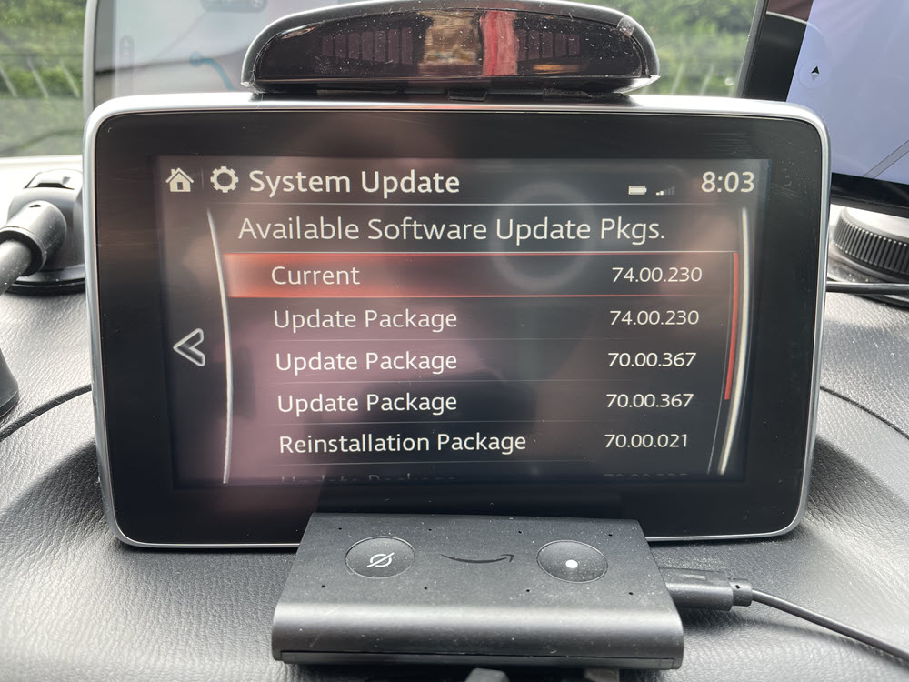

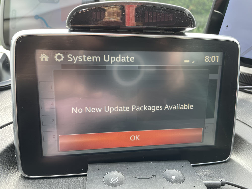

Sorry I can’t help you there. My issue lied within Mazda’s firmware update. It caused the car to not recognize the adapter as a CarPlay device. It still had WiFi. I’ve always had my adapter on the March update. Rolling back the car firmware to the previous one fixed my issue.
