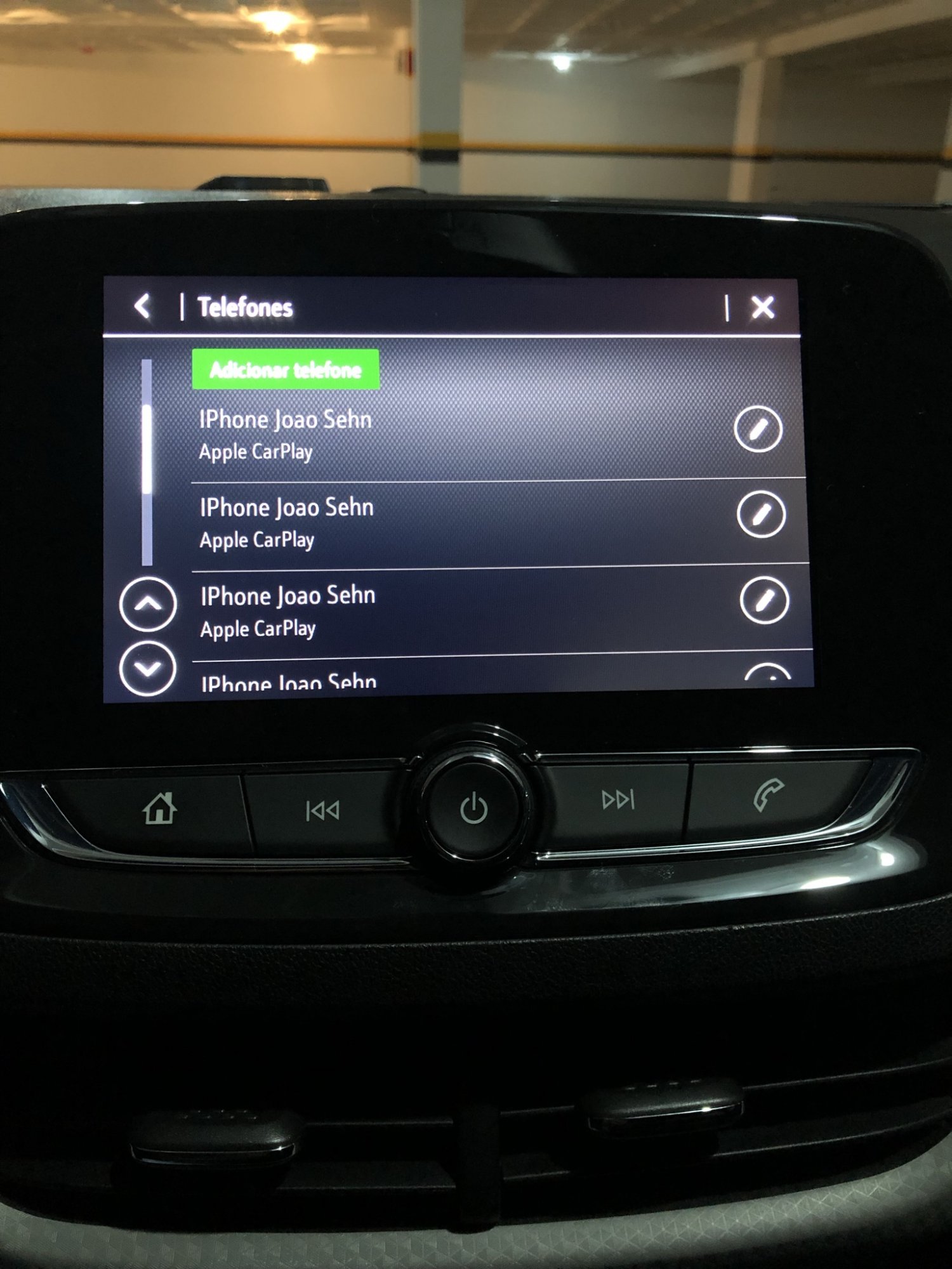

The only downside of this solution is that every connection it creates a new device in the list.
It is realy. I do not know how many device can be included on the phone list. I believe I will have delete the unused devices sometimes. Reset the MyLink 3 is not good for mim.
