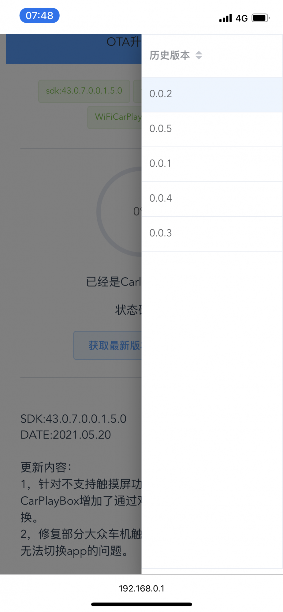

@dvuon Wierd thing. Downgraded to .06 with sd card, went to the car and still had problems with the connect/disconnect.
I went on the OTA page and flashed some files from there, its a list with them, and then flash the last update, and i think now its working. I think i have .09 now.
Will test more.
Reactions: dvuon
Will test more.
Dang. Hope it works! So .0.6 was stable enough for you to update OTA? It didn’t do the whole disconnect and connect thing? And Did you update to .0.9 OTA too? Or through SD? I don’t see a .9 on your screenshot.
@dvuon Nop. It didnt work, after leaving the car and coming back after work it started to do the connect/disconnect issue.
I opened a dispute on aliexpress for refund.
I pressed the update button from the middle of the page and i think it updated to the last version available.
But there was a version that was stable enough for you to do an OTA update. Shouldn't that one be the one firmware that works with the Mazda?
Nop, it just connected and i didnt hit the knob to start carplay and the OTA page worked so i did the updates.

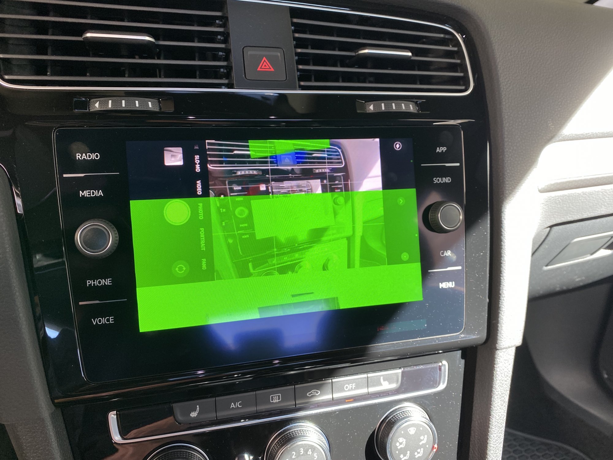

Received both the Podofo and Cheerdriving units today. They're virtually identical though there are some UI differences. Both exhibit the same broken screen mirroring though; needless to say they'll both be going back to Ali and gonna stick with the Carlinkit v3 for now.
