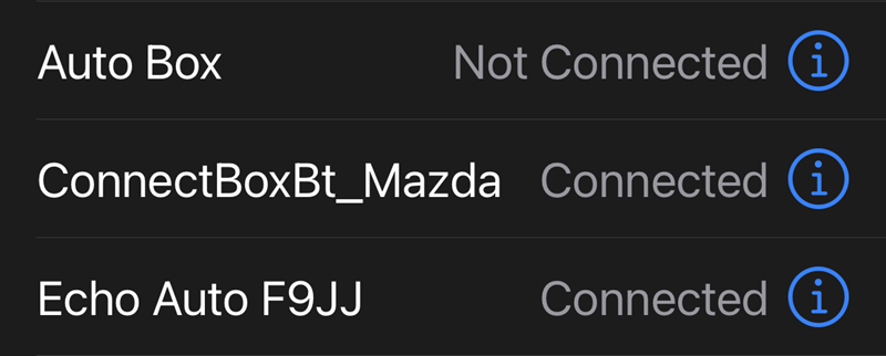

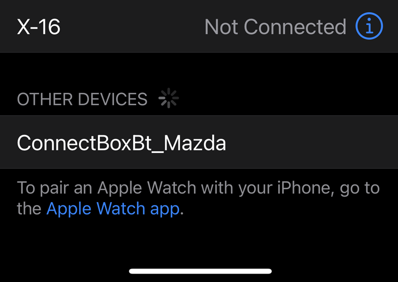

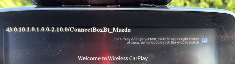

Updated to 43.0.10 in my Mazda running the latest v.70. Upon reboot Podofo, I saw the CarPlay on my Mazda with podofo for the very first time.
Follow the instructions to bring up iPhone Bluetooth scan and found the BT. This was not possible on the firmware 03 through 09 for me.
Tried to connect to the BT, failed on the first attempt but the second time got connected.
Seconds later, my navigation app showed up on the screen
On the road, I intentionally disconnected and reconnected the power to podofo and it reconnected without issue.
The first test went well.
I will see what happens tomorrow morning.
I dis the update too. Same results. Its a little better, we need more testing.
After 1 week of conections we can say that it works.
