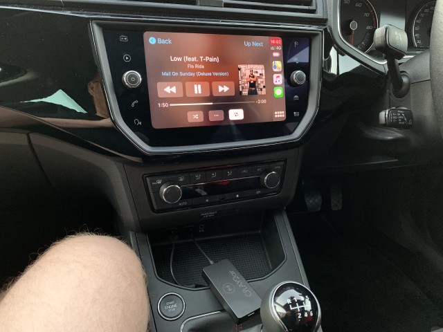

I’ve set my wife’s iPhone up with it now and ran some tests. It all seems to work perfect.
the only funny I found is after a phone call, the head unit turns off, but this only happens when using it without the ignition on. With the ignition on it all works great. The real test will be when she uses it tomorrow......as it’s different
It looks like things are working for me also. Will try it some more the comming days but it looks good for me for the things I could test right now.
