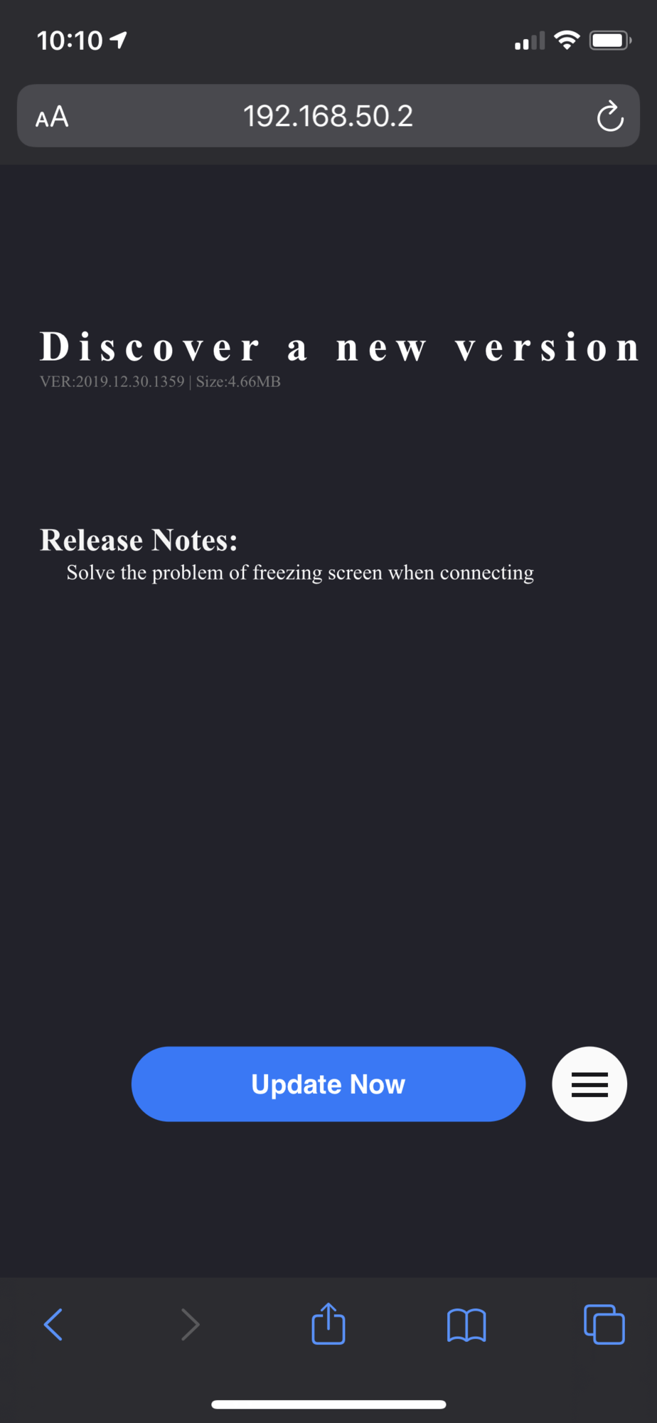

another new version today, somewhat ambiguous, im almost tempted to never update again....Jeep wrangler uconnect 8.4" working almost near perfect, anyone wanna test this one out?
