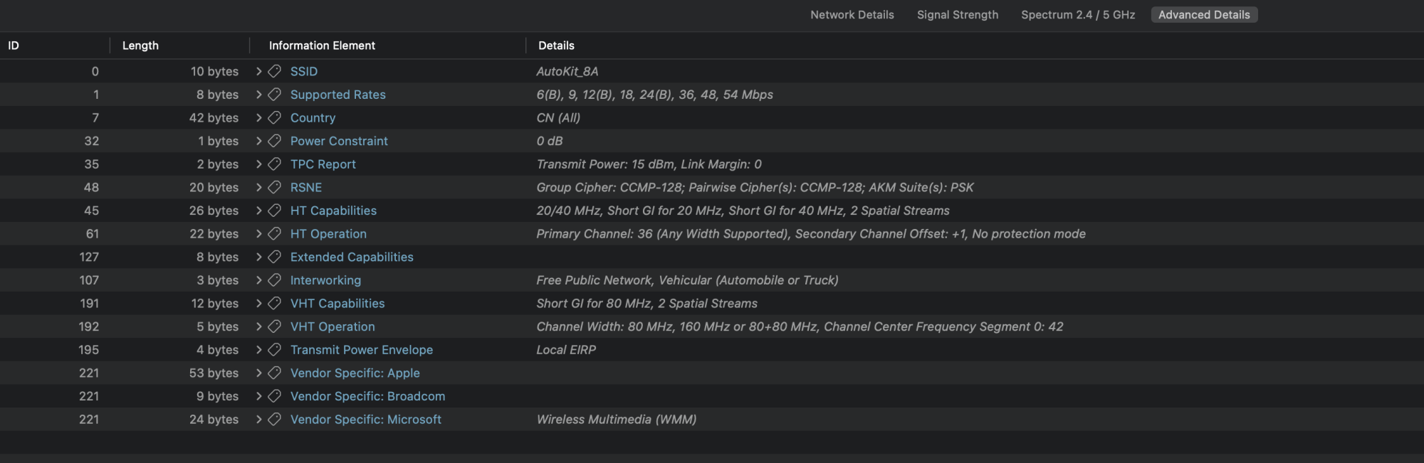

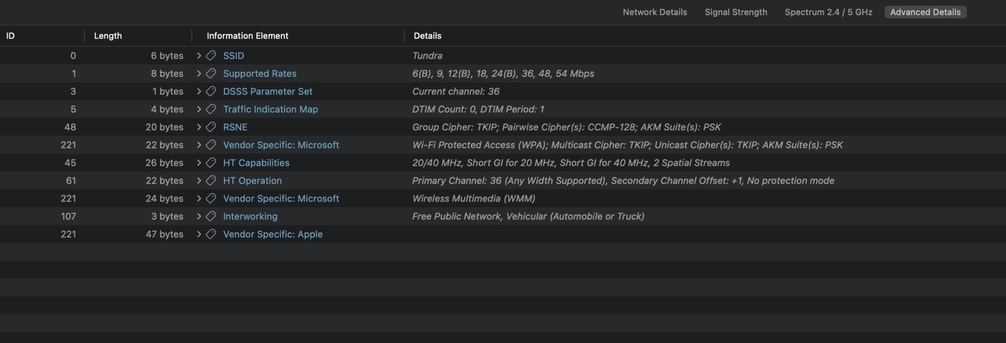

Just upgraded my v3 to a v5. It's a little bit smaller. Wireless improvements are noticeable, haven't taken it on a long drive yet (just received it). I own a 2020 Tundra, the v3 when upgrading to the latest versions (from version 2022.07.29.1625 to 2022.12.14.1349), my phone would stop connecting - it would still display in my Head Unit, but iPhone wouldn't recognize it as CarPlay. Resetting to defaults, etc.. never fixed it. Always had to rollback to the older version. Even tried before ordering the v5 when everyone mentioned the new firmware, the v3 didn't see anything past 2022.12.14.1349. I figured I'd buy the v5 and give it a shot, seems promising. I'll probably convert my v3 to a travel unit and use it in rental cars that don't support wireless CarPlay, or as a spare if an update borks the v5.
I'm excited for the new wireless standard... I'd have reproducible interruption when on my commute driving through specific areas with higher wireless interference. I am hoping this will help reduce those, but if that doesn't help... Now I can set the wireless channels to something in the higher range, or even 165 @ 20MHz.
My v3 was wireless N, running at 40 MHz max speed 300mbps.
The new v5 is wireless AC, running at 80MHz max speed 867mbps.

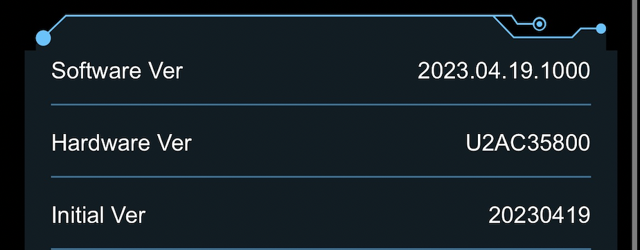

Additional v5 info from web GUI (latest version reported by v5 as of 05/30/2023):
View attachment 2209938The new v5 is wireless AC, running at 80MHz max speed 867mbps.
Additional v5 info from web GUI (latest version reported by v5 as of 05/30/2023):View attachment 2209939

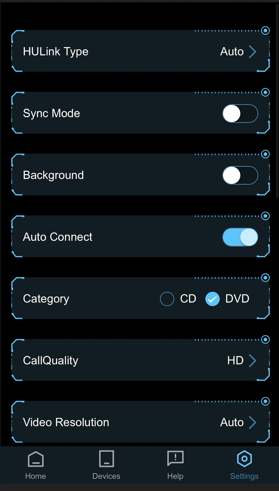

Do you see the Wi-Fi "AutoKit" show up after 20-30 seconds? If so, you should be able to connect to that, regardless of what your Head Unit is showing (you could also power it off a standard USB power, not connected to any hard unit), and browse to 192.168.50.2, the v5 has an option under "settings" for "HULink Type" mine by default worked with "Auto" but you have the option to manually choose CarPlay and AndroidAuto... You may want to choose CarPlay and see if that works?

Good to hear! My v5 is running great. Might be placebo, but seems to be much snappier. I still had some cutouts on my commute running on the lower channels (36), I ended up jumping to channel 165, which forced devices to run at 20MHz, and the cutouts went away. I could likely run 80MHz on some of the other upper channels, but seeing as 165 is rarely used by anyone, I think it'll be the most stable.
So far, no regrets bumping from v3 to v5.
Considering that Wireless CarPlay is 10mbps only, a 20 MHz channel should indeed be enough. A 20 MHz channel for sure is less prone to interference than a 80 MHz channel, especially in the higher frequencies.
