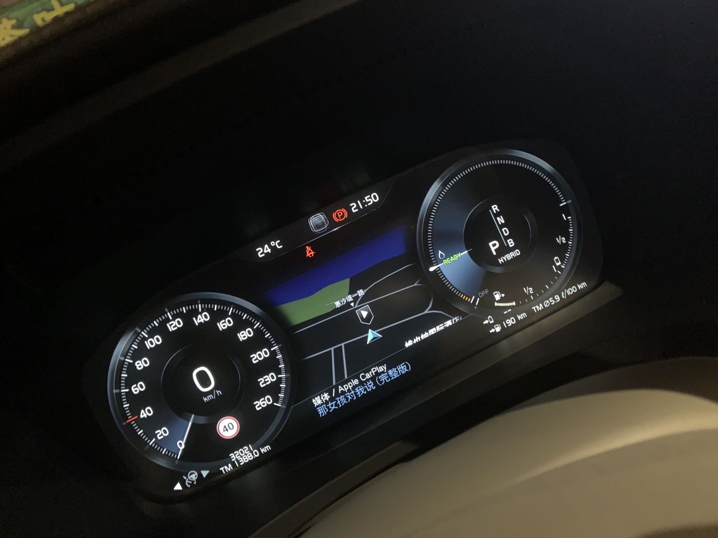

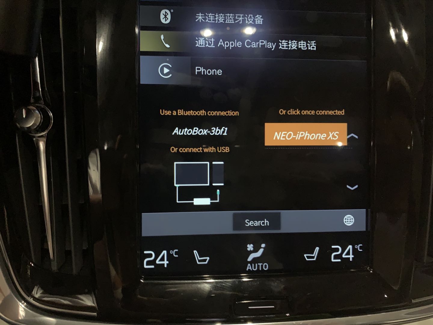

For me the unit works really well I would however like to see the button used to answer and end calls on the steering wheel functioning correctly along with the info in the dash. That would be fantastic as it works for the wired carplay experience (see video). My car is a 2020 model Volvo XC60
Oh, the meter information was added in version 2.0,
[automerge]1579058414[/automerge]
We added the online upload log function in version 2.0, which is a very effective way to solve the problem. Our website is carlinkit.com
I see you have info in the dash. In on the latest build but have never seen this. My unit is only a few month old is v2 a firmware build or a newer box?
