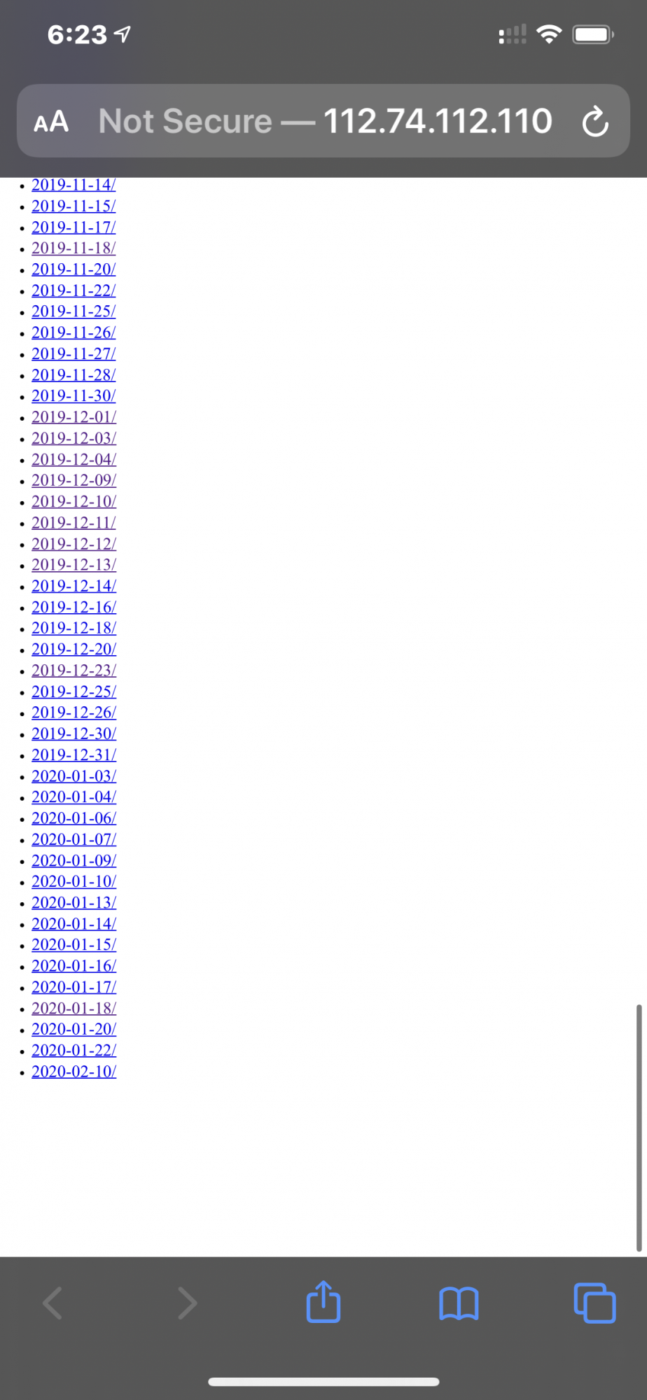

have done the repairing before... seems this dont helped too.
Must be something in the steps that i forget or isnt wrote here do make it working again.

There is. It’s the 10th Feb today. Look inside that and you will see an update for today. It’s a U2W image file. I believe the OTA update comes a little later

Look inside that folder and you will find the normal update image. Obviously at your risk.

Now there are 3 .img files in the today folder. 1 in the Hicar and 2 in the tmp folder as dated today 11 February.
