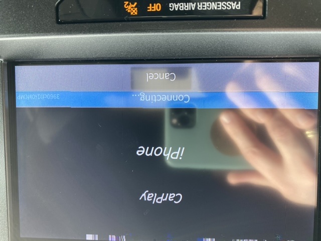

Here is all i get when trying to connect to 2019 F150
Maybe someone else can confirm but it looks like your adapter is on the old (pre 2.0) firmware. Version 2.0 was released in December 2019. Pre-2.0 firmware definitely does not work on Fords. If you look back through the early pages of this thread there's a link to a special firmware version that will upgrade your adapter to the 2.0 level. Then you can flash any of the subsequent firmwares that were released in late December and January. I think someone earlier in the thread with a SYNC3-equipepd F150 said that the December 25th firmware worked best for him.
UNFORTUNATELY though, I'm not sure you will be able to activate your adapter after flashing to the 2.0 version. There are a few of us in this predicament right now. Due to the Corona virus in China, apparently few to none of the Carlinkit people are going to work. Their activation server has been down since late January and last I tried (middle of last week) it's still not working. So my adapter is not activated and thus will not work at all.
I am outside the return window for my Carlinkit--otherwise I would consider returning it. But as it stands now I have no choice but to wait for them to fix their activation server so my Carlinkit adapter can be activated. Once it is, it should work in my Ford. But for now there's nothing I can do.
For you, if you have the option to return for a full refund you may want to consider that. Who knows how long this Corona virus outbreak will last or how much worse it may get.
